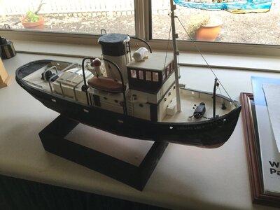

I sent my model tugboat from Australia to England by post with no problems. I made a heavy duty cardboard carton to fit and set the boat in tea towels then packed it all round with polystyrene beads. Wrapped the carton with lots of gaffa tape and marked fragile and this way up on all sides. Cost about $30 to post. Arrived with just the prop off and a couple of bits of rigging to be re attached.

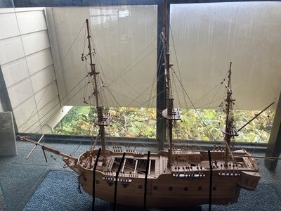

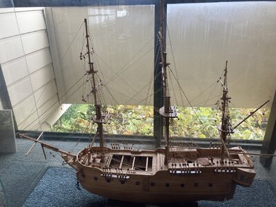

Photo attached, as requested--this one made by a friend.
Cheers.
Is it this box you mentioned in first post?
I would suggest little more secure points as others mentioned before. Here you have photos of box that looks very sturdy and was successfully sent
