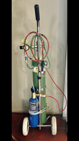

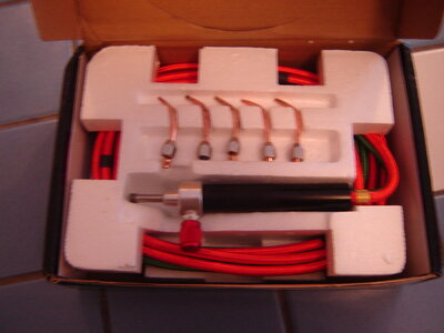

My new jewelers oxy-acetylene torch arrived yesterday. It's a cheap little thing ($35can) but it works well. I did a couple of joints with my hard silver solder that my butane torch wouldn't melt and it was fine. I was concerned that the valves wouldn't be smooth but it's very easy to adjust. The only thing wrong is that the hoses are too short (6 feet) for my shop layout so I'm going to have to figure a way to get my tanks closer to my vise. Sometimes cheap crap works.
My tanks are much bigger but I should be able to come up with something. Thanks.
I did some searching and discovered that my torch is a counterfeit.
It is a very good copy but for $35 it must be a copy. All the fittings worked on mine( unlike the video) so that wasn't a problem. I didn't know it was a knock-off when I bought it as it wasn't advertised as a Smith on Amazon. I thought it was just a cheap Chinese torch. It wasn't until I got it and saw that it said "Smith" on the back of the box that I got looking. I knew that Smith was a good brand and that they went for a lot more than $35. Anyway, we'll see how it lasts.

I also bought a low cost Chinese copy for a similar amount and for the price it's not bad. Over here downunder the genuine one from a jeweler's supplier is around the $400 to $500 dollar mark way over my price range.

Your picture twigged a thought. I have an old hand truck in my crawl space that will work perfectly for this. It is too light and flimsy to carry any amount of weight, that's why it's stashed away in the crawl space.
Thanks
