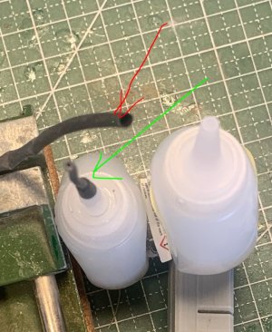

Using a shrink tube (it shrinks if heat is applied - flame or hot air ) reduces the amount of the glue and it enables precise point application to the object.Another advantage is , it is always ready for use.If it is dried on the edge you can apply heat to the tube to get rid of the dried glue.
More details in the attach.Red arrow before and green after shrinking process at 300 degree Centigrade using a hot blower
Hi kurt
Necessity is the mother of invention

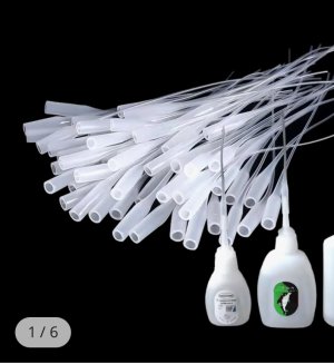

Because i have forgotten to bring my CA pp-extenders 300 km away from where i am now since about 3 months for summer vacation,thought this is the solution and it is functional.The plus point is the shrink tube is less unflammable than the pp- extender which i bought via aliexpress (about 100 pieces- attachment)so you can burn or melt the dried CA without damaging the edge.
Kind Regards from Gallipoli- Saros Bay

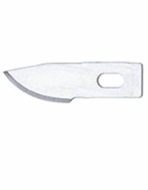

Another method I was introduced to years ago that works well especially on gluing tight seams is to use one of the small curved exacto blades (see photo). Make a little puddle of glue then pick up a drop of it with the edge of the blade, then precisely rock it into the seam. Capillary action will draw it in - no mess, no residue where you don't want it.

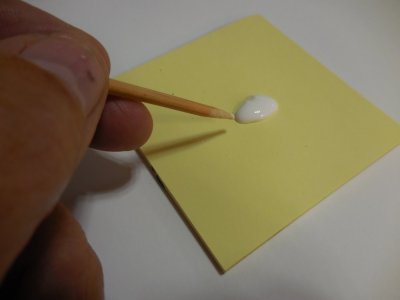

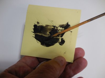

Great use of Post-It pads. Mix glues and no messView attachment 478600 View attachment 478598 pads

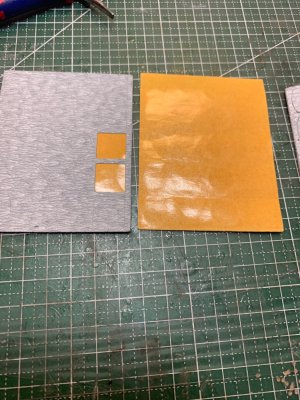

I will also recommend to use ordinary baking- paper.If i cannot find any BP in our kitchen so i use the reverse side of the proxxon sanding papet.

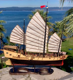

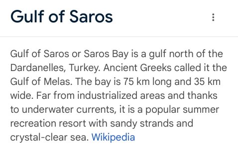

This place is Gulf of Saros ,my summer vacation place since about 34 years.I attached some more of my shootings.
Last year Red Dragon met the sea here.at the moment trying to finish the masts of La Curonne from Corel
