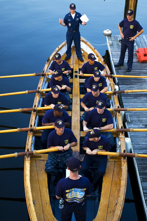

Can someone explain single and double banked oars to me? I've read a few explanations and still walk away confused.:confused:
Two paddlers sitting on the same bank (thwart) side-by-side manned double-banked oars. Where single banked is the one man only.

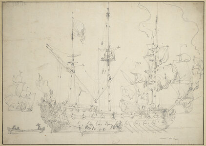

did you see also this topic?

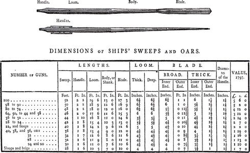

And especially take a look at this page, showing a list with the oar dimensions (from David Steel 1797) connected with the number of guns -> also bigger vessels had oars in the earlier times

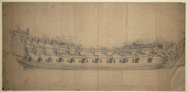

f.e. this is the HMS Tiger, a 38 gun ship launched in 1647 with 460 tons

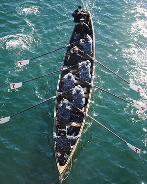

Thanks guys. What about the same arrangement as single banked but with two men per oar? Was that ever done?
I'm not sure what I'll say now .... perhaps at the beginning of our history, and the history of the conquests of Alexander the Great, there were ships with such a movement device. When two, and possibly more people moved a huge oar. The ships were called diremas with two rows of oars on board. And triremes with three rows of oars...
