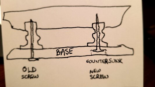

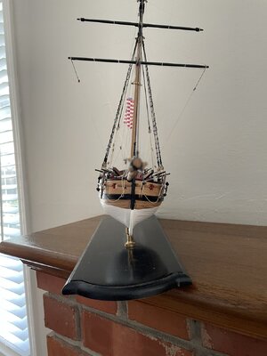

I quote Cosair. The Issue is the kind of pedestal you elected, a figure that operate its leverage right on the wooden mahogany strake (I remeber that kit well enough) glued to the bulkhead and reproducing the actual keel. On my last model I drilled deeply two holes right in the plywood of the bulkhead and then I used two mere carbon rods of 3mm as pedestals. A minimalist (I hate whatever element of the presentation interferes with hull's lines), rigid and definitely robust solution. So, my hint is to fix the keel regluing it in place, restore the painting work and then to operate two brand new holes at a certain distance from the damaged areas.
Any screw seriously "biting" could otherwise damage model's inner structure even further... IMHO.

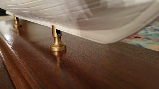

I encountered the same problem on one of my ships. Using a larger screw probably will not work unless the direction of the original hole is changed or a new hole is drilled. I solve my problem by inserting a small wedge (like s split washer) under the appropriate side of the pedestals. Simple and completely unobtrusive. This will work only if the amout of lean is slight.

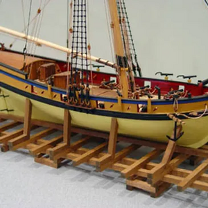

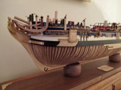

Typically, a model will be supported in four different ways. The first, and least used, is with supports that are similar to supports used in a shipyard, consisting of number of stilts holding up the hull.
The first, and least common, is the use of multiple supports, often simulating those used in a shipyard to support a hull during construction. This is often used in drydock dioramas.

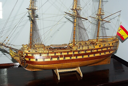

The second is using cradles or saddles, either mounted to a baseboard or as part of a stand assembly.

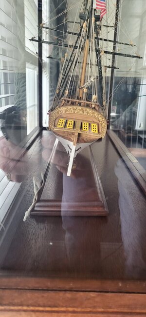

The third is using a combination of pedestals and cradle to offer lateral support for the model.

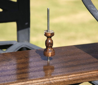

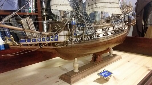

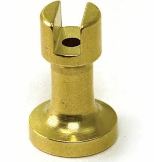

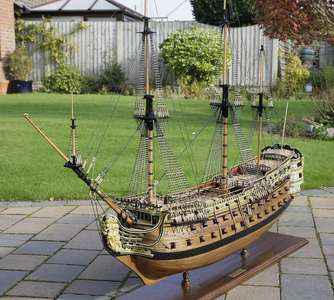

The fourth, and most traditional method, is the use of pedestals. This is the method I will go into some detail on. The pedestals often have notches where the keel resides. These are not sufficient by themselves to hold the model upright. If used without further support, there is great danger snapping off the keel or break off parts of it should the model be bumped from the side, If the model is heavy, the weight of the hull itself may be enough to cause this damage to occur, and it doesn't matter how tight the keel fits in the notches. The model will want to lean over to one side or the other.

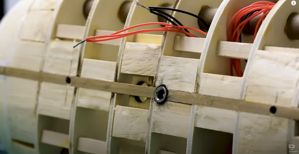

You need to plan how to mount the pedestals right from the beginning, at this stage in construction.

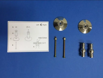

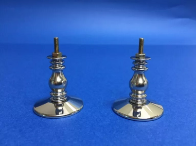

A pedestal assembly usually includes a treaded rod or screw which passes through the pedestal, and up into the hull, where it engages an internally threaded fastener, typically a nut. In the instructions below, the pedestal nut simply rests on the inside surface for a plastic ship model. For a wooden model there is more to be done, as will be explained.
Below is a picture of Ohla Batchvarov's model of a Ragusan carrack. Note all the solid wood around the holes in the keel for strength. You can see two holes in the keel where the threaded rods or screws will pass through the pedestals and into the hull, plus and electrical socket between them which is used to power the internal lights. What you can't see are the two nuts higher up inside the hull which are encapsulated on all sides with solid wood about 3-5 cm above the keel. The higher the nuts are mounted in the hull and the longer the threaded rod, the more support is provided. These metal nuts accept the threaded rod or machine screws. The nuts are glued into solid wood so they cannot come loose or rotate. The threaded rod or screws are inserted through the baseboard, pedestals, and into the model and are tightened from underneath the baseboard.
