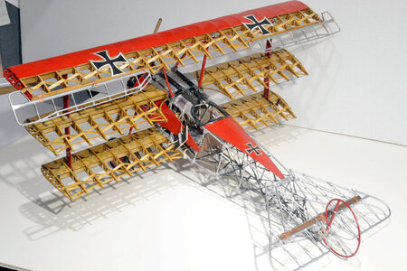

I have started to build the Fokker Dr1 Tri-plane (well they did call them "air SHIPS" in the early days) and a large part of the construction is using Brass tube, rod or photo etched parts as well as Cast parts in Britannia (a form of pewter) and Zinc. I have an old 25w standard single heat/element, single shoe electric soldering iron which I have used on small electrical wiring jobs but nothing very intricate. I understand that I may need variable temperatures on the different metals, would I be advised to buy a variable heat soldering iron and if so, butane gas or electric? And what about the solder, would a lead free universal solder be OK or to buy flux and high and low melt solders??

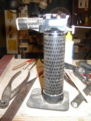

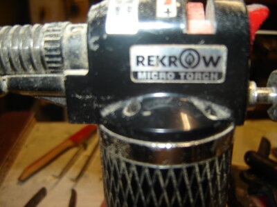

Gas/butane for me. The micro torches are instant on instant off..no waiting for the element to heat up, and you can use MANY different alloys to solder or braze. Pinpoint heat as well.

I have gas irons for out 'in the field', but I find you have next to no control over them for fine detail.

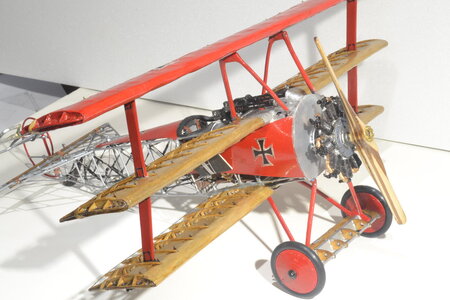

Thanks for the greeting - following up from my questions about the soldering irons, I have been beavering away on the Fokker D1 (Model Airways) which is almost complete. I have been a little frustrated with the kit in so much that the cast metal parts (which form the main structural body of the plane) are very soft and distort very easily and impossible to solder, they just melt away even using low melt solder. Before starting another boat/ship, I am about to try their other model the Sopwith Camel, which was the British rival to the Fokker D1. The SC doesn't seem to have as many cast metal structural parts.

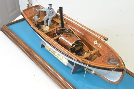

Before I started on the airplane, I built the James White Steam Boat, a very enjoyable build but found some of the plastic parts too small to handle and very fragile.

You show us two very different vessels of different media: Air and Water. Both great to see so well done.
Rich
