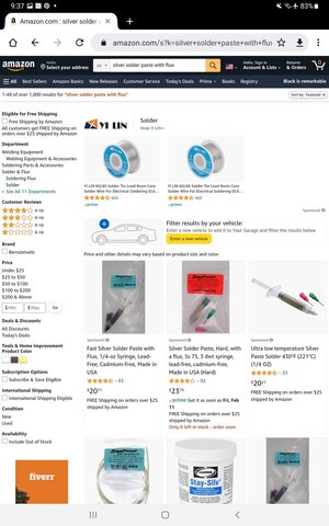

I'm trying to purchase the soldering paste that's been referred to a few time on here. What I'm talking about is the flux mixed with finely ground silver solder. When I asked at local shops they usually hand me a jar of flux. When I explain that it should have the solder in it I just get blank stares. If I search on the web I get a whole gamut of results most of which don't actually say what I'm buying. What should I be asking for? I prefer to use Amazon.ca so I don't have to plaster my Visa info all over the net so I'm a little shy of buying something from "Joe's Soldering Shop in West Fencepost, Iowa".

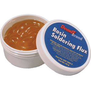

Like this?
I use this stuff: Solder-It

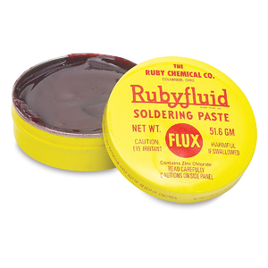

Just to complicate things, I have an old can of Kester flux(what my Dad called paste). It is labelled "Acid Paste Flux". I suppose the "paste" is to distinguish it from liquid or powdered flux but I can see where Dad got it from.
To simplify things, Don, you absolutely CAN NOT solder parts using just flux (without solder), however, you CAN solder using just paste as it contained solder particles and flux.
