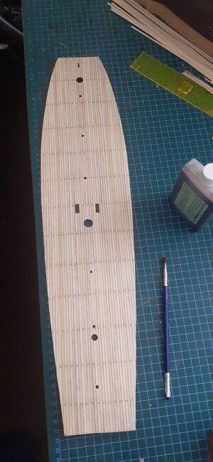

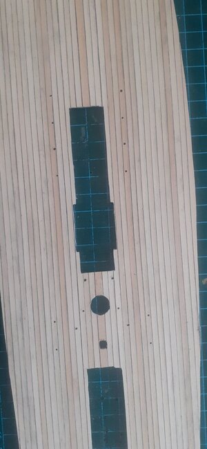

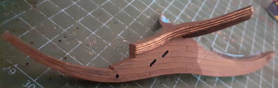

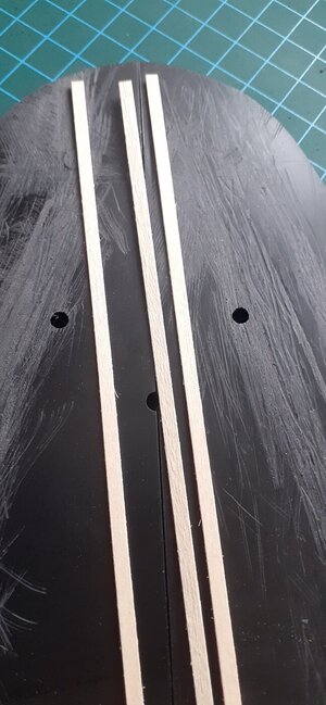

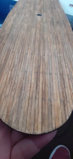

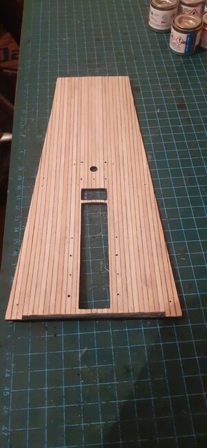

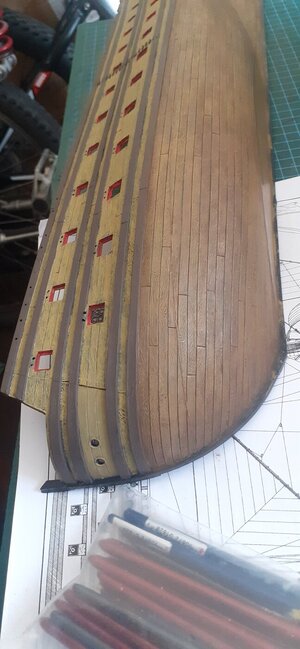

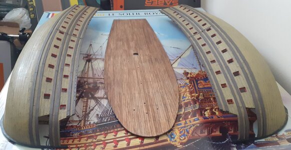

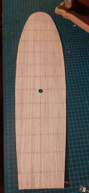

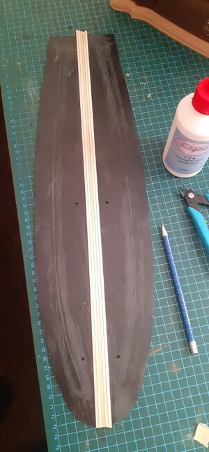

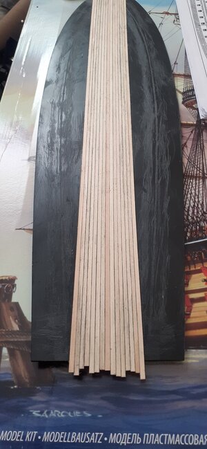

I wanted to have wooden decks throughout so I meaured the sizes of the planking on the decks, calculated how much I needed and bought in 80 x1metre lengths 3mm x 0.5mm lime wood.
The planking has gone really well and I have now finished it all, I also stained this with a Dark oak stainer.

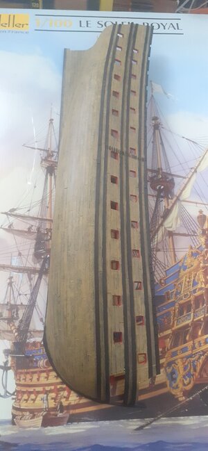

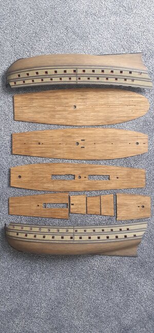

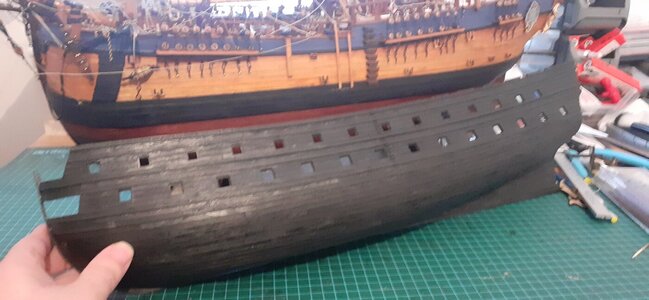

The Hulls I was unsure about but went with the kit instructions using Humbrol brown yellow and a lot of drybrushing, this came out darker than expected but realising this was because the mouldings of my kit Hulls are solid black(I used the same brown yellow on my complete Royal Louis but since that mould was in white hence the colour originally close to what it should be).
That said I was quite pleased with the darker finish as it gave it more of a weathered look. I thought the bottom of the Hull needed to be slightly darker though so I used a Humbrol Dark brown wash over the brown yellow and it really came up to what I wanted. I have also drilled holes over the gunports, as intend to rig pulleys for the port Hatches.

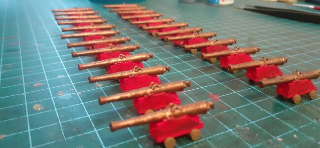

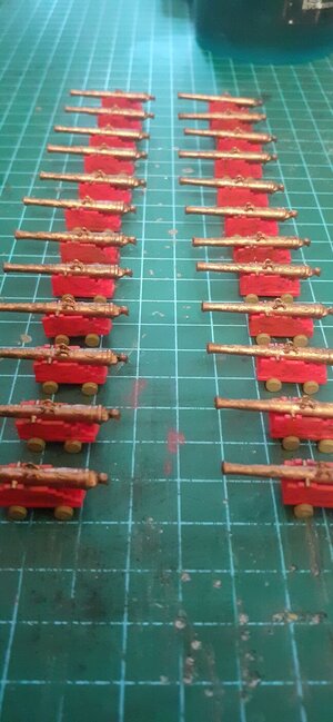

Atm I am now just building and painting the guns. I've finished the 24lb(x24) and have just started the 18lbers. I was originally thinking to replace them all after sales but found it well nigh impossible to get the correct type of gun and in 4 different correct sizes, so I've had to stay with the kit supplied ones.

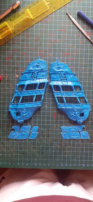

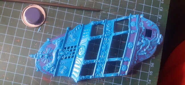

After completing the 112 guns started painting one of the side Galleries which I have opened up.
This is by far the most intricate model painting I have done. Very rewarding and very happy so far . The gold will have to wait as the inconvenience of work beckons

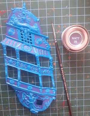

SOLEIL ROYAL : Heller 1/100 (side project cont'd)
Small update

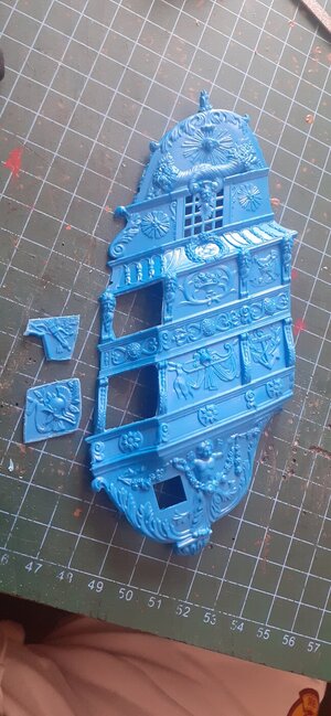

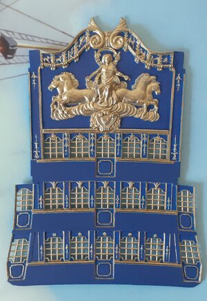

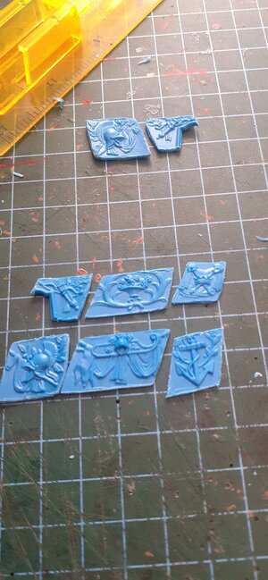

Stern Gallery painted just to add a slight wash and of course any touch ups I've maybe missed. I have painted the 7 Hexagonal type panels blue instead of Gold as I intend to add decorative work to these and I will be adding some more decorative pieces to the SR at a later date.
This has taken most of the week out with work, a highly detailed piece but very attractive. It's only when you are painting these parts you appreciate the work that has went into designing moulds through the process of Engineering, I take my hat off to Heller for producing a Superb Historical work of Art, it must have cost a fortune to produce this at the time.
Yes these kits have been around a long time, I just wish more on this scale and magnitude would be produced.
Next up will be the wash then the painting of the side Hull architecture/Gun ports/railings or the Architectural Bow fittings.

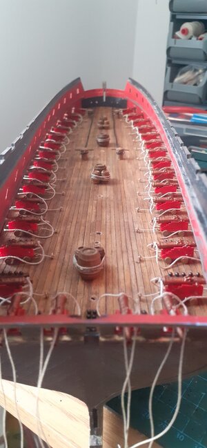

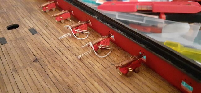

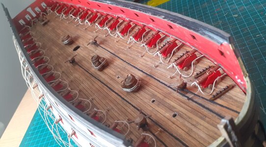

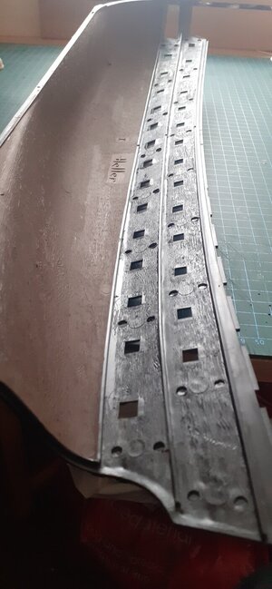

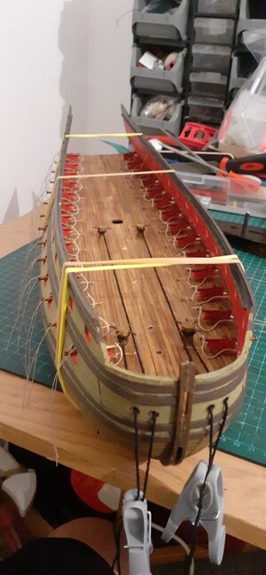

The lower deck and 2 sides of the Hull are now joined, I have rigged up the lower deck Cannons using 2 sizes of thread, using 1mm & 0.5mm Amati beige thread, albeit not fully as the angle curvature of the plastic Hull made this impossible, obviously with wood you have a lot more leeway regards space as your building the Hull.
I have also rigged up the 4 Capstans on the lower deck using 1.30mm Caldercraft thread, and I am now in the process of rigging the ropes for the Gunport Hatches using 0.5mm Amati beige thread, the Hatches obviously will be added much later into the build.
I am tempted to add more detail to this deck but not sure if I should as this deck will be hidden completely from view. Cannon balls, Cannon loading utensils, belaying pins, Rope hanks and Barrels/kegs spring to mind for detail addition.

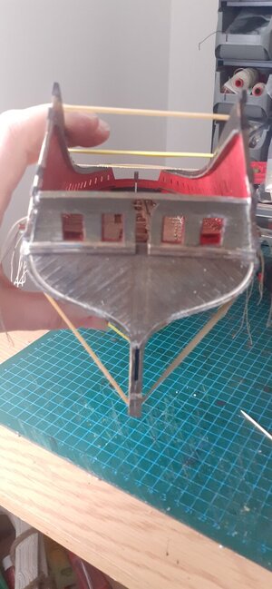

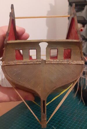

Not the best of Lower Stern fittings on the Soleil Royal having to fill with putty then obviously will be painted once dried.
Just glueing together the bow structures before painting begins.

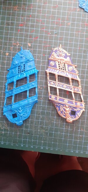

Side Galleries painted just to add a weathered wash. It's took the best part of 3 days to finish this to the best of my abilities. There will probably be still the odd bit here and there that maybe touch up, as with detailed painting like this you always notice something later on.
Apologies for the photo, the blue in the photo looks lighter than it actually is, it's actually more of a mid blue (Humbrol matt 25) to be exact.
Next up will be the wash then the painting of either the stern or the side Hull architecture/Gun ports/railings.

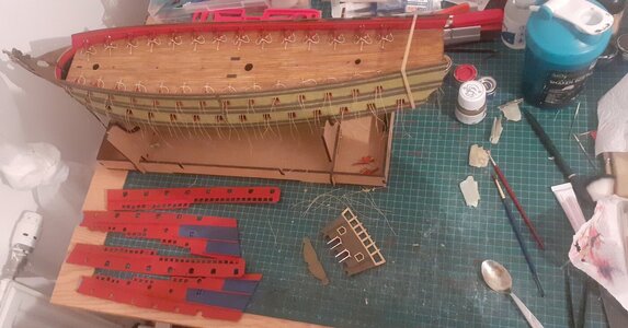

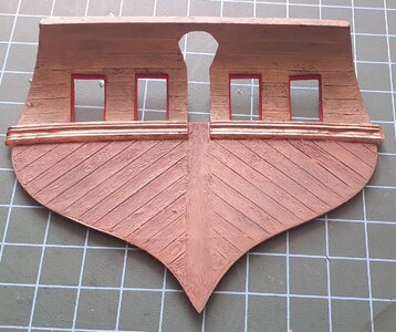

Well the putty filler worked a treat, and the stern looks spot after a light drybrush and wash applied.

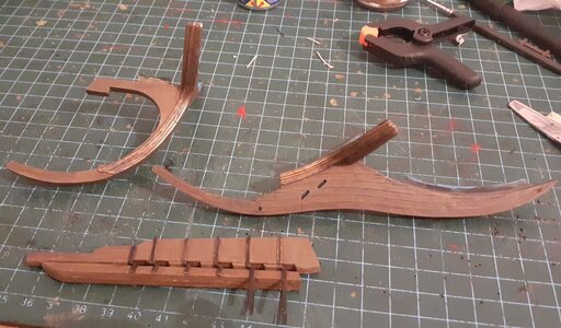

The bow segments have now been painted and wash applied to both the wood effect and the Gold architecture rails(black wash).This was done slightly differently from the Hull to get the same shade of wood effect. This was because the 2 Hull halves were moulded in black so only needed Humbrol matt 94 brown yellow applied thinly and drybrushed then the Humbrol Dark brown was applied. The bottom of the stern and bow sections were moulded in a light blue colour, while the Rudder sections were moulded in white, so to get the same shade effect I dry brushed Revell matt 8 black firstly òn the base of these sections, then obviously once dry, again drybrushed Humbrol matt 94 brown yellow, before applying the Humbrol Dark brown wash again to get the weathered effect.
Next will be to size up cartridges to hold the cannon balls which arrived yesterday.
As well as building the Ship stand within the kit as I will be nearing adding the bow sections and Rudder as well as the 2nd deck.
Small steps but slowly coming together.

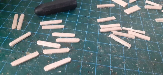

Cutting and sanding to shape, Carriages for the Cannon balls. Will scribe a groove down the middle to hold Cannon balls in place these carriages will of course be stained although I haven't decide which wood colour yet.
Just for the record the carriages measure 20mm x 4mm.
Much same way as I added them to the Endeavour.

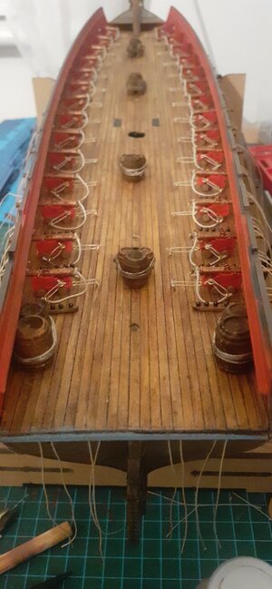

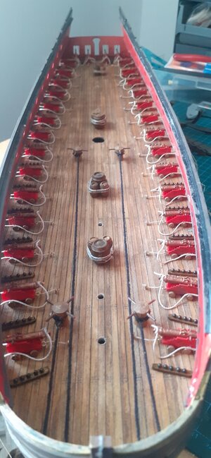

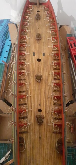

Lower Deck detail finished on the SR even though this deck won't be visible.
26x24pdrs & 6x18pdrs rigged.
32x Cannon ball carriages(stained in Walnut) with 160 Cannon balls, 4x14mm Barrels & 8x10mm barrels.
Next stage fitting the 2nd deck.

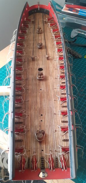

Good day,
Your" wooden" effect of deck painting is such cool !!! Well done sir!

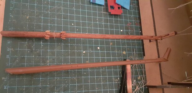

But for me it is not clear what did You want to show with this capstan cables gears arrangements..?
It doesn't work and looks like that which You shown to us...
There must be messanger where anchor cables attached to, and this messanger which is an endless rope , moving by capstan, moves anchor ropes to the anchor ropes box...
and capstan bars, they need to be 3 tines longer at least...
all these details of anchor,s gear You could find in the books of the period...for example "Arming and fitting of english ship of war 1600-1815" or "J.Harland - Seamanship in the age of sail" and many others as well... of couse if it does matter to You, if not, ... just do with Your model what ever You want to do, what do You think will be right :)

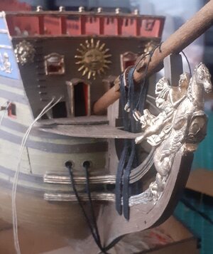

Small update...

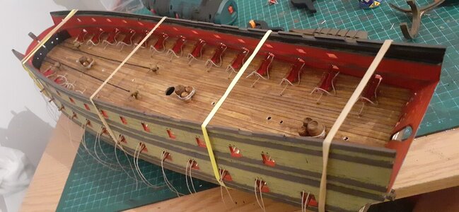

2nd deck is now fixed in place. Now rigging Cannons slightly differently as to lower deck, I would have liked to have used 2mm blocks but these were just too big and out of scale regards to the Eyepin positions I had to fix on deck rather than the Hull sides which wasn't possible due to it being thin Plastic, if this was a wood kit it wouldn't have been a problem.

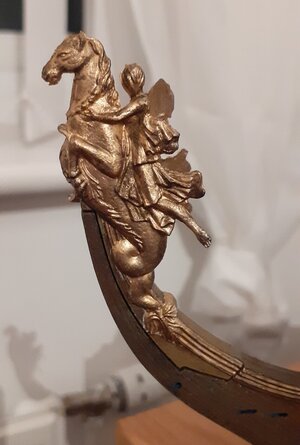

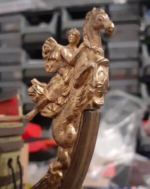

I have also 3/4 painted the Bow bulkhead and have fully painted and weathered the Figurehead.
It's been a bit time consuming regards to deciding on colour schemes and with all the parts moulded in different colours doesn't help regards to finalising the same shade as other parts of the ship moulded in another colour, as the basis can affect the the final outcome.
I think also I will be replacing all the masts and yards with wood, this will be a big undertaking in itself.

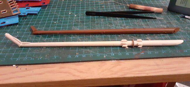

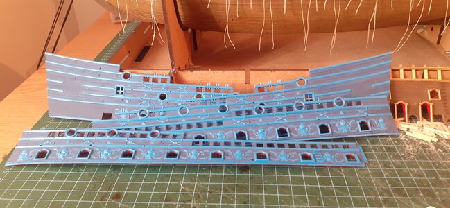

I have however finished the 2nd Deck with the full compliment of rigged Cannons along with Cannon balls + carriages, Barrels/kegs. I have also made the Bowsprit from wood and stained it, as I intend to replace the masts and yards as well as planned.

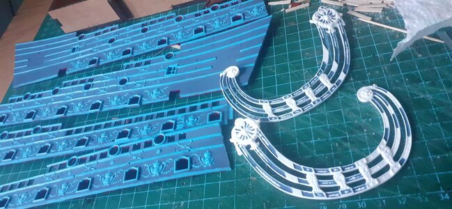

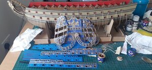

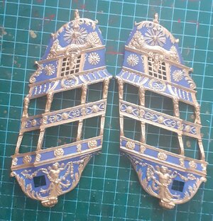

I have been painting the Blue on the 2 architectural sides of the Hull as well as both architectural bow sides. This must be the most intricate painting on such a large volume that I have ever done.
It's not been easy to get motivated, on and off modelling doesn't help when there is too much going on elsewhere.
Nearly halfway with the painting and soon the gold will be started, another job in itself, however like everything else it will be worth it in the long run.

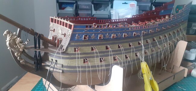

Just looking ahead and wondering if there is a better source for Soleil Royal rigging instructions as the Heller ones are pretty poor.
Does anyone know of better rigging instructions for this ship?

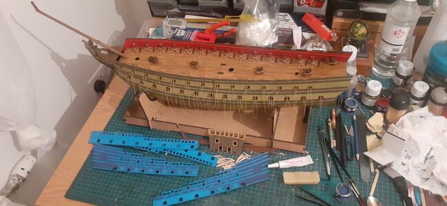

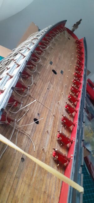

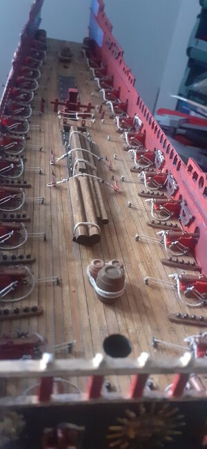

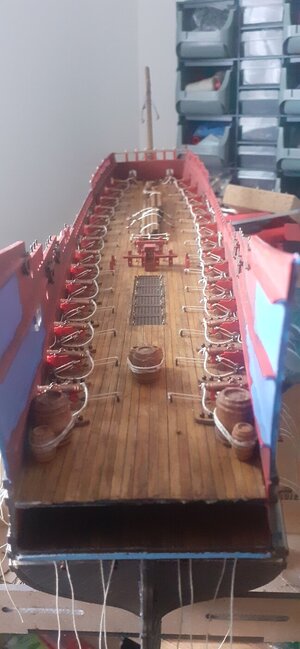

Main deck now finished, Cannons rigged, deck detail added regards to Cannon balls/carriage, barrels/kegs spare wood for yards etc.. stairwell rigged and eyepins added to gratings. 6 running rigging lines attached as per instructions 2 of which get rigged to the Main sail as far as I can make out, will obviously have to double check the poor rigging plans just to be sure.
The Hull architectural sides are all permanently fixed.
Slowly coming together
