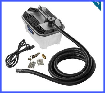

Using the Rockler unit for generating the steam. Hose connection is in the back end of the box.
