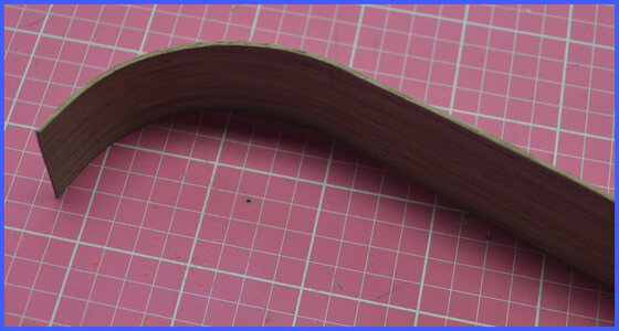

After moving to canoe country, NE Minnesota, I was given a dilapidated wood Canvas canoe, aka Old Town type. I went to restore/rebuild a total of four of these beautiful antique watercraft. Anyone attempting to work on these boats must master the art of steam bending. The closely spaced ribs; canoes have ribs not frames, are steam bent 3”x 5/16” white cedar and some of the the 3/16” white cedar planking also must be steam bent.
It’s not nearly as difficult as it appears! My first setup used a camp stove as a heat source. While this worked fine, I wanted to be able to steam wood indoors. A Weber electric wallpaper steamer proved to be an ideal heat source. (Festool now makes a look alike steam generator marked to the boatbuilding trade for several times the cost)
The only real requirement for the steam box is the ability to withstand the heat of boiling water; 212F (100C). PVC pipe won’t although I have used it for a one off job. My steam box was four pieces of red cedar with a piece nailed over one end and a hinged door on the other. Leakproof joints are unnecessary and possibly dangerous as they can cause pressure buildup. A drain (3/8” hole) should be drilled in the far end and the box sloped slightly. That’s it! Thermometers or monomers are unnecessary as steam temperature is what it is coming from the steam generator and the box should leak enough to prevent pressure buildup.

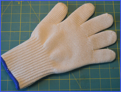

A pair of barbecue tongs are useful for removing hot wood from the box. I would be very careful of gloves as you can get a bad burn if steam penetrates the fabric.
