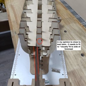

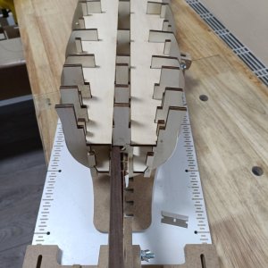

Yes John I have already elongated the hole not sure how far stbd it has to go 4-5 mm?
Not sure how to advise --since I "bashed" the bowsprit, Sergal kit bits not to my liking - but note that mast upwards angle became an issue later in my build - it was too low and figurehead did not have proper spacing - Also I did recenter the mast angle forward - Mckay does not as you saw in his image ...
The center line of the bowsprit was offset from the centerline of the keel to starboard 18 inches (5.6mm at 1:78). This was from an AI search so their information may be from an unreliable source. Buying into this information is up to you, so caveat emptor. From John's post it sounds like McKay addresses this in part. There is the model at RMG. If it is accurate, I am sure you can enquire about this from their staff. They are usually pretty good at getting back with the information although summer holidays may drag it out.

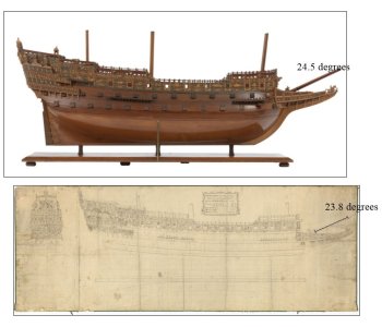

This is of no help, but maybe interesting. The angles on the contemporary drawing and the model at RMG are really close. The date of the drawing is unknown and the model is from 1830 so one or both could be how she looked when she was refitted and renamed Royal Sovereign in 1660 or they may just be wrong.

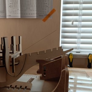

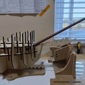

How does this look for angle and position? nothing finalised yet so able to change it.
It will move more to the stbd if needed. according to info on the net it only has to clear the foremast!!
I'm too lazy to measure the angle on your picture, but a commonly used angle is 24 degrees. This is also where RC Anderson puts it in his book on Rigging in the Days of the Spritsail Topmast. I wouldn't make the angle smaller than this, but some models have it as high as 44 degrees.
One thing I forgot to add was the distance. The reason the bowsprit was offset in these early ships is because the foremast was set so far forward. The bowsprit was offset to keep it from bumping into that mast. So, as long as your bowsprit clears the foremast, you should be OK.

That second image is from somewhere at google images FYI

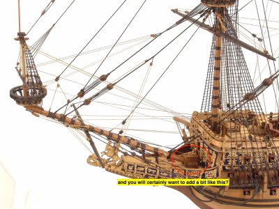

PS2: note that figurehead is also too close to mast Hmmmm - the issue that I had as well
