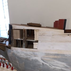

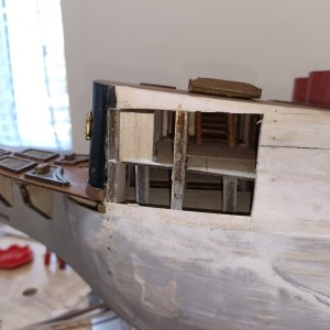

Did a bit this morning, a few problems one being I have no Idea where the waterline is and the instructions are really bad and two the panels for the bulkhead is damn near impossible to shape to the shape of the deck bulkheads (scallop shaped) If I soak in water it de-laminates so decided to wing it and build the bulkheads with planks.

You are quite right, it was a 'guess where the waterline goes' and I put mine a bit above your green line. You have done an amazing job on the deck bulkheads. I had terrible trouble bending the damn things. I wish I had thought of your brilliant fix.
Early start and managed to do a few gun ports. This kit is not the same quality as the Victory and having to wing a few things that don't quite fit properly but that's the beauty of wooden kits (you can fettle stuff)
