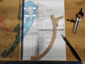

This project consists of the execution of a Spanish galleon from the first third of the 17th century.
For some time I had intended to make a model of a galleon, however, had been postponing it in time, always crossing some other project.
However, as a result of my attendance at the International Modeling Congress of Rochefort, I decided to start it as soon as possible. The main reason is that, curiously, despite the popularity and general attraction that accompanies the Spanish galleon, there was not a single model of a Spanish galleon in that Congress. I think it's a gap that needs to be filled.
It is not surprising that such absence, since in general terms, there are very few galleons of a certain quality, I do not say already in racket, that can be found. There are, in effect, kits of some but all suffer from the limitations of the assembly kits.

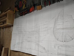

The project will start from the plans of the plane executed by D.Luis Fariña Figueira, naval engineer, and was the result of an investigation that was made in the Naval Museum of Madrid about the galleon San Pelayo de Menedez de Avilés, I emphasize the fact that the traces of this plane are only a starting point, in any case, said traces agree almost perfectly with the provisions of the ordinances of 1613, so they are fully usable. The model will be in bower and for the elaboration of the internal structures I will follow other sources that, in a moment, I will specify.

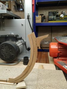

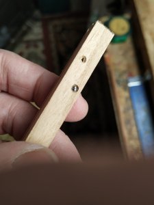

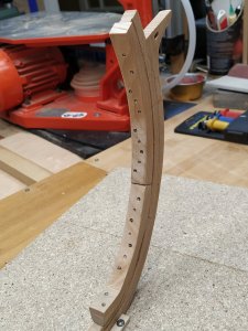

#19
The three pieces of keel come to be equivalent, to scale, to about fifteen meters each, it is a considerable measure. At present it is already difficult to find this measure in the oaks of the forests of northern Spain, according to experts say over twelve meters is already complicated by the birth of the branches etc.
One of the characteristics of the keels of Spanish galleons is that the keel segments are not joined by escarpments, but go to the top with each other. The bonding of the whole takes place by means of the keelson, the claps, "albaola" etc.
This procedure was mandatory according to the ordinances of 1613 and characteristic of Spanish ships. The reason for being of the same is that it favored the tightness. For this purpose, a pin was also introduced into the joint, just below the joist to increase this waterproofing. In my model is included
