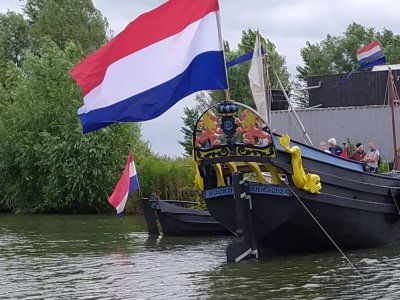

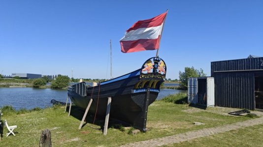

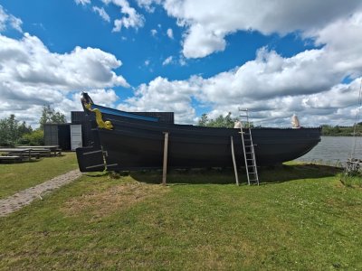

Last Saturday I witnessed the launch of the full size replica of a Dutch 'speeljacht' (pleasure vessel), executed in waste plastic by my friend Edwin ter Velde in Hoorn, Holland.
The ship is 12 meters long and entirely based on Witsen's description in his book 'Aeloude en Hedendaegse Scheepsbouw en Bestier' (Old and Modern Shipbuilding and Managing) from 1671.
The projects supports the idea that waste plastic should be a material to build with, not to dispose of. Besides the wharf in Hoorn offers people 'with distance to the labor market' plenty of opportunity to find their way back into the world.

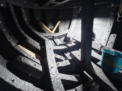

First a few pictures of the ship under construction:
IMG-20250409-WA0000.jpgIMG-20250522-WA0003.jpgIMG-20250528-WA0000.jpgIMG-20250513-WA0002.jpg

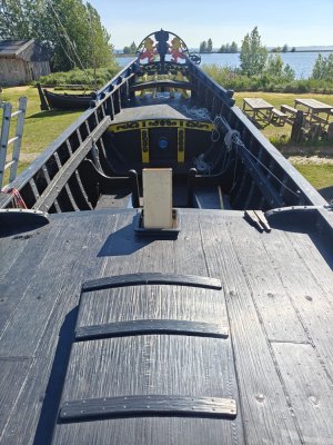

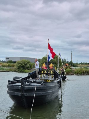

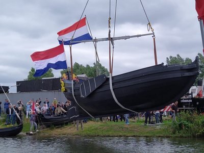

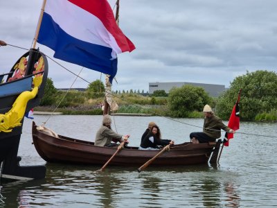

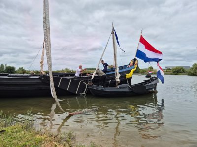

Here are some pictures of the event:
IMG-20250705-WA0001.jpgIMG-20250705-WA0000.jpg20250705_154622.jpg20250705_154424.jpg20250705_154403.jpg20250705_154330.jpg
