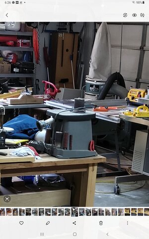

I'm trying a new tool, an oscillating spindle sander, for sanding ribs and frames. I used it this morning for the first time. I want to be able to true edges before any necessary fairing. I like the initial results but the machine is a bit noisy. It's bigger than I thought when I ordered it. Price was reasonable ($125.00 USD). There are more expensive models available but this is fine for my projects.

Hi. I purchased the Wen oscillating spindle sander and my experience has been very much like yours. I wanted square edges on all of my frames and bulkheads.
The machine was much bigger than I expected and OMG LOUDER than a diesel bucket loading tractor! My current project does not have a ton of frames. I found myself thankful I didn't have to use is for any length of time.

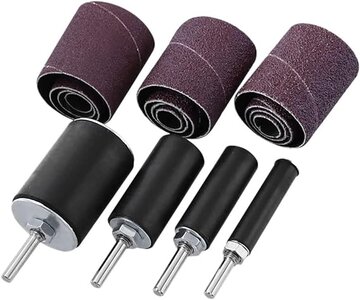

I actually made myself a non-oscillating version with cylindrical sanding heads made for hand drills and a homemade bed with drilled holes to accept the sanding cylinders. Takes 3 minutes to set up on my drill press and is many, many decibels quieter than then Wen monster. I seriously would give away the Wen if someone really wanted it and was willing to pay for shipping.

Ken you're correct about the size and noise of the Wen spindle sander. I didn't check the details before I ordered either. On the positive side the heft keeps the machine in place and from "walking" around on the work bench. I do like the results I got the first time I used it however. I'm not clever enough to make my own as you did. I'll live with it.

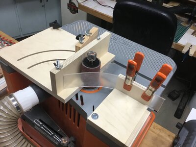

I was successful using a Dremel in the routing table accessory ($35) in making a set of ~30 frames without too much difficulty. The only hard part were bevels; the drum head is not very long and can be extended only so far. I 3D printed a few 1.5" drums and that worked well. Finally, I got a drill press for other reasons and bought some nice drum sander bits from Lee Valley, got a hole saw the same size and cut into a platform, and ended up with a 3" high spindle sander. Buying a table top hose clamp from Rockler and using the shop vac was also very handy for the mess this can create.
