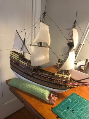

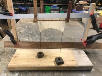

I bought fine, all-cotton muslin cloth from a fabric store and dyed it with tea. for dimensions, I could use the spar lengths for widths and eye ball for heights. I scribed the out lines by pencil and lightly penciled in the seam lines. Then with wood glue, I glued a tan cord ( bolt rope), about .021" around the perimeter on one side. The wood glue disappears when dry. I cut the sail out keeping as close to the bolt rope as I could. Then I glued another bolt rope on the other side of the sail as close to the edge as I could, finishing off the edges. I built a little jig ( pictured ) that clamped to the spar an hooked up temporary sheets to the sail. I used a fan to shape the sail so it looked as if it was catching the wind. Then I sprayed matte varnish about 4 times to keep that shape. The spray brought out little "nubbins" from the cloth itself so it has a rough texture but is not really noticeable. The first picture is of the Mayflower without the sprit sail which was shown in the jig. I like the looks. I tried a flat foot but I prefer the billowing look of a curved foot.
