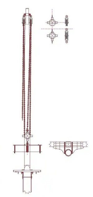

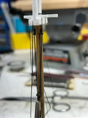

Well summer activities have surely slowed progress down on Staghound....however, I did get in a bit of time to make one of 3 topsail yard double eye gin blocks for their haulyard system. This tiny metal gin block is roughly an 1/8" in size with 42 LPI chain. It quickly dawned on me that I needed to install all the topgallant cross tree gin blocks prior to full install of the shrouds or I would have to work in extremely tight quarters to do the job if I had waited.

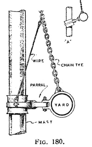

Instead of using the typical Flying Fish topsail yard haulyard the model maker prescribes....my research led me to conclude, a more robust double action system was called for. the single action design, would mean there would be 2 sides, with a port and starboard purchase...requiring 2 separate crews to operate them.
Here are some images of the set up on the model....to include one of the design used and another showing that a single top tie for the chain is needed to attach the parrel wire to...so as to provide equal support for it and the yard truss. The haulyard used on the Flying Fish model provided by manufacturers would not work, since both sides of the haulyard chain are mobile.....making that design unusable. My parrel tie wire will attach to the center chain of my gin block...which is not movable. Again...this all had to be planned out and installed before the shrouds could fully be installed.
