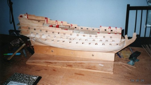

Correct--this is what happens when you don't do that--the white spots are putty covering patched gun ports which were incorrectly placed.
That happens occasionally. Luckily any modifications or corrected to the hull's first layer don't count, because you can correct them and cover over the seams with the second planking layer! The double planked hull has this advantage over the single layer hull.
