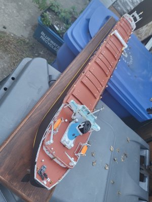

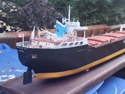

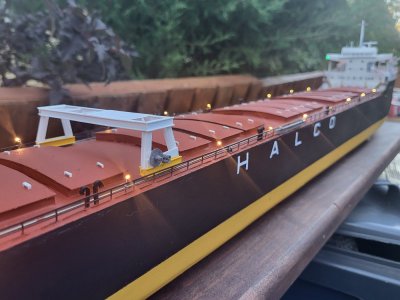

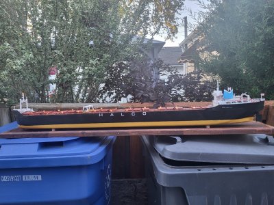

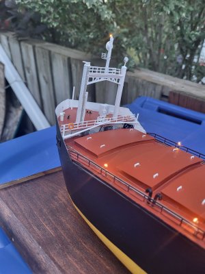

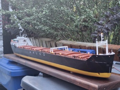

This model is scratch built using the drawings from Davie Shipyard. This is now my 5th laker model to add to my fleet.

Your ship is impressive. I have a question for you, is the hull carved? It looks very straight for the length (4ft or better I would guess). Can we see the rest of your fleet sometime?

The bow and stern are shaped (not necessarily carved) basswood, the sides of the hull are balsa. This allows for a hollow hull so I ran wiring for the led lighting, and really reduces the weight!
Correct....the length is around 46" long.
