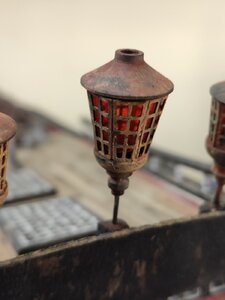

Hi Uwek,The stern lanterns of the Victory are now painted with this typical yellow occre
But originally they were golden in most cases - I guess also on the Santisima Trinidad

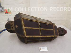

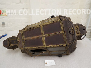

There are two interesting original lanterns from appr. 1760 on the web page of the NMM, seems from the same ship
View attachment 159130 View attachment 159131
