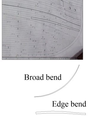

Hello everyone, up until now when planking a hull, I used to bend the strips by keeping them in water for a while and then shaping them with a heating iron. With this method, some of them would break, so I have devised a tool to mold them without breaking, giving them the exact curvature required in each case. Here I show you the contraption I have prepared for this purpose.
Basically, it consists of a metal cylinder—specifically made of aluminum—which is kept hot at the desired temperature by means of electric heating elements, a PT100 probe, and a temperature controller. The cylinder moves along some guides I made from DIN rails via a worm screw. On both sides of the cylinder, there are a pair of turrets (or revolving holders) fitted with small stainless steel rollers measuring 10 mm in diameter, which help bend the strips.
Finally, I'm showing you the temperature controller I used, although any model will work. Here are the cartridge heaters and the PT-100 temperature probe. The final assembly is the one shown at the beginning.
