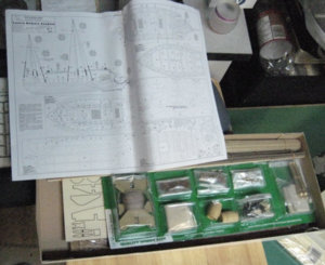

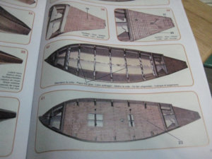

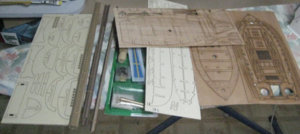

The Kit contain a 40 pages instructions book 1 identification plan for the parts a tools catalogue and the wood is well packed
The instruction look to be clear and very well done

The building of the frame is made with strong plywood laser cut.
The precision of the piece are astounding every single one of them fit with perfection without any adjustments at all and give a frame strong and straight as an arrow in the end

It is the perfect kit for a beginner as most of the part are already prepare. The only difficulty is the fact that is no writhen instruction at all only picture so in some step you have to study maybe 3 or 4 pictures in the same time.
