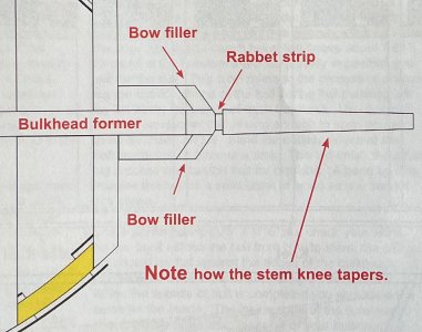

The proposed method of ‘building’ the rabbet onto the edge of the bulkhead former (the spine of the model, hereinafter called the BF), rather than cutting it into the side of the piece strikes me as very clever and likely to produce a neater rabbet than I’ve yet managed. Hurrah! [NB. I always put my captions below my photos, where they are supposed to be.]

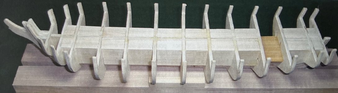

I’m accustomed to plywood underdecks on which to lay the deck planks. Syren requires me to plank across the tops of the bulkheads with voids underneath much of the deck. I’m scared of heights and afraid I’ll fall into the voids with my partly unsupported planking and build a deck which simulates the long swells of the ocean rollers. I’ve achieved this interesting but hideous effect while hull planking too and it seems to me that if I extend the filler blocks outward and downwards, completely filling the hull, I’ll make the planking easier on deck and hull, assist me in the fairing, and perhaps even eliminate the need for two layers of planks on the hull. This requires some thought so I’ll be using that big hammer to beat some sense into myself in days to come.

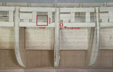

The other feature which is new to me is this Idea of framing the gun and sweep ports with huge lumps of timber and building the bulwarks in the manner of the real thing. Formerly I’ve been required to build solid bulwarks and then cut holes in them, tidying up the edges with a thin sill. The Syren way looks like one of those places on old maps marked “Here be Dragons!” It’s going to be the first place in the build where I start using up my timber two or three times faster than anyone else in a series of do-overs for each piece needed. Measure-twice-cut-once-offer-up-throw-away-start-again-again.

I trust that I won’t have to build sills later on and, to be fair, they were almost as fiddly as this method.

One example are the sweep ports dimensions. They were typically 10" up and down by 12" fore and aft on English ships (5/32" X 3/16"~ 4mmX4,76mm) at 1:64
