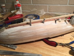

I used Elmer's white glue on the Artesana Latina Virginia model, along with some clamps that screw into the underlayer. These hold the planks in place while the glue dries. I got the planking clamps as a package of 6. You can see that I also used some tape at the plank ends. This garboard plank has twist at both ends.IMG_1344.jpeg
