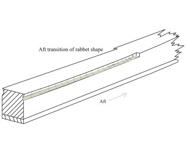

Keep in mind that the rabbet shape is dynamic in that it changes to match the angle of the framing along its entire length. It is near 90 degrees at the after most part of the keel. Sometime in the 18th century it ended short of the sternpost but I have never been able to find out why this change happened and would like to find out why this took place.
This is beyond helpful, Thanks! But the change is interesting and from an engineering perspective I am curious as well. Continuing the Rabbet up the sternpost in theory would protect the ends of the hull planks, and seem more hydrodynamic if the shipwrights on the 18th century had discovered the science of flow yet.

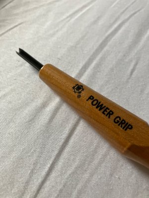

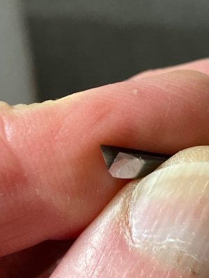

V and U shaped small chisels are available for cutting Lino blocks for printing art. They are excellent for cutting the rabbet.
This particular range is Japanese, about £10 each and using them is truly a joy!
View attachment 493969View attachment 493970
I was able to find the same set on Amazon for $20. Five chisels, sized from 1.5mm - 5mm. Thank you for the advice!
The inner post is not as thick as the stern post and it does create a rabbet even when the rabbet on the keel came up short of the inner post. Hard to explain in words how this works but you can see the step on many contemporary drawings on the RMG Collections site in low resolution and quite a few of these drawings in high resolution on the WikiCommons site. There are about 3000 drawings on the Wiki site, with about 800 of them in high res. https://commons.wikimedia.org/wiki/Category:Ship_plans_of_the_Royal_Museums_Greenwich.

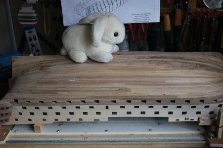

Hi, 'Doc', here's the rabbit on the keel of my Victory! ROTF

G'Day, here's a rabbit on the keel of my Victory Exclamation-MarkROTF (sorry, I just couldn't resist it, Mate!)
