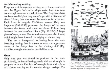

And a scan from the monograph Mary Rose. Your Noblest Shippe. Anatomy of a Tudor Warship, 2009:

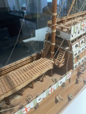

I am currently building the Mary Rose and also referring to Your Noblest Shippe - the build log is ongoing on this site. The anti-boarding netting is shown on the Anthony Roll illustration -
As you can see, all decks have the anti-boarding netting. However, now I have rigged my build it would be impossible to add netting to any deck other than the main deck which has no rigging tie-offs. The rigging lines would have to pass through the netting making it an impossible task to tie them off if the netting is fitted first.
I may add the netting over the main deck and think that ran over a beam spanning the two bulkheads. If I do I will probably tie the netting myself as readily available materials either have hexagonal holes or just do not look right. I am still mulling it over.
