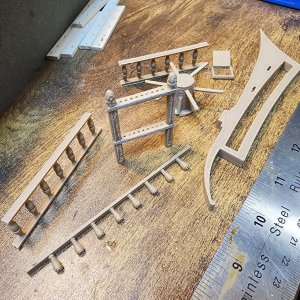

I could not make some ship parts like ladders and turn styles because of the complexity in
cutting and assembly. My left hand was just not steady enough and I gave up.
After a long talk with myself and fiddling around I started to draw patterns to assemble them.
I knew AutoCAD and Solid works and used this. Then I thought what if I could print them.
Long story short I bought a very inexpensive 3D printer and...
This may be sacrilegious to the purist but I don't care.

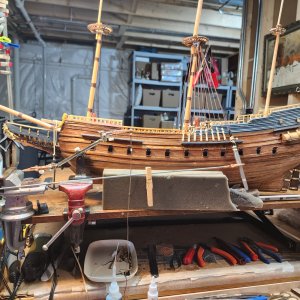

Now I have come to the standing rigging. At this point I started and quit five or six times.
Each time walking away to never return. But I did.

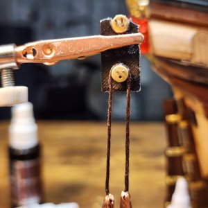

I found I have to find a way to hold something with a device or contraption so I could work with my one
stable hand. I was stumped at first but...

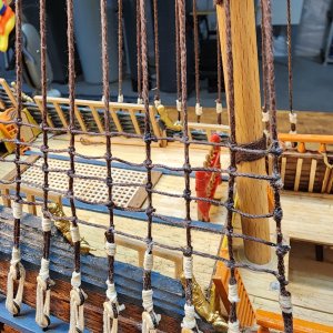

Now I am on to tying knots for the rat lines. Big problem here because I can not use tweezers very well.
Not stead with the right hand and not well coordinated for intricate work with the left. After many tries
practicing, tying half hitches' on a dowel in a vice I got it. I have to make one movement then fix the line
with thread glue then make the next bend around and hold it with thread glue then finish.

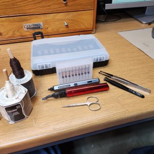

Other very helpful tools are the mini drill and sander because they are light and small. Easy to handle.
