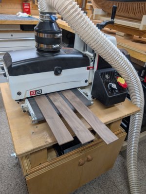

I have the Byrns thickness sander but I found it difficult use and to get a consistent finish!! I ended up with the (Jet 10/20) it's small enough but will get the job done and save you a lot of time!!! I'm very happy with it so far, only thing is you have to play with the tracking on the feed table belt every so often, other than that it works fantastic!!!! ✌️

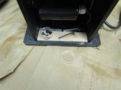

I have a Micro Lux sander. Almost $400 6-7 years ago. I have to tell you that drum changes are a pain in the @$$. You have to disassemble the drum mechanism from the motor. Then remove thesleee from the drum. My drum is a snug fit. I've tried oil, baby powder to get a sleeve on. My final solution was to put the drum in the freezer overnight. Then the sleeve would go on fairly smoothly.

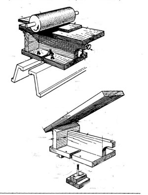

if you have a lathe i guess you can build a thickness sander for it
As far as using a drill press sideways are you really applying that much pressure to make a difference?

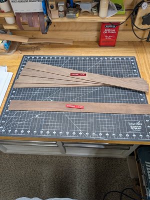

I buy my timber from Hobbymill in Estonia, the postage is pretty crippling so I buy an expensive stock of sheets. If I run out of 1.5 mm thickness and need 1mm for planks I could use a thicknesser and prep 1mm planks from the reduced sheet. Or use a Byrnes saw to reduce the plank thickness of individual planks like Olha. Her technique works well enough, possibly more accurate that a thickness sander, and certianly more accurate than a home built hand fed machine.

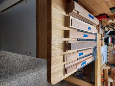

Today I needed 3x0.8 mm Castello strips. But I only had one 2x2 strip and one 3x10 mm strip. So I cut the 3x10 into 1x3 mm strips using the small Proxxon table saw. Then I smoothed the strips with a small Kanna (Japanese plane) and made sure they were 0.8 mm thick. You don't always need a drum sander in our hobby. It's handy to have one if you need to thin 100 of those strips. But most of the time it's gathering dust instead of being used. Use the tools that are useful. And if you want to make a DIY drum sander, check out the link in my signature. It contains plans and a description of a machine that works well. Without hinges that can be inaccurate.
By the way, my Kanna comes from Aliexpress, which was only €3.50, and after sharpening the blade properly and sanding the block straight on a glass sheet with a sheet of sandpaper, it is a very nice plane that is not inferior to a Bridge City.

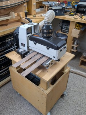

I use my Jim Byrnes thickness sander every day. It replaced an old Preac thickness sander from Charley Files. I even extended the feed tray on the Byrnes to 16”. It is also very easy to change sanding paper and uses regular sanding sheets, so its very cost effective. You can have two different sizes of paper on the drum at the same time. I still use the Preac for resizing made parts as i can place very small parts under the drum sometimes using a jig to hold the part from flying out.

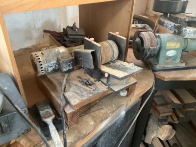

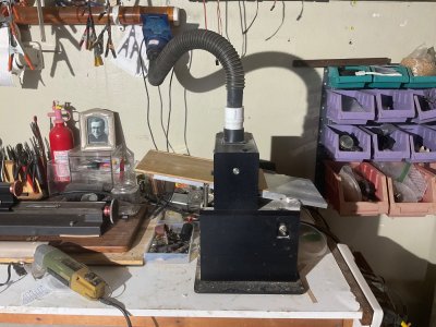

I made a dust cover with a shop vacuum hose port for my NRG plans thickness sander.
My machine has a 11" long and 9" diameter Hard Maple platen. About all that was available in the 1970's was 9x11 sheet paper backed sanding medium.
The shape of the sawdust funnel is a five sided box without a lid. The sides extend down to the pillow blocks to hold the cover high enough not to block the drum.
To make your own:
Measure the dimensions of the five pieces
Glue three layers of Amazon box quality corrugated cardboard with a generous and complete layer of PVA glue. (use weight for a tight close bond). This will make a thick side for each of the five pieces.
Enforce on the inside each of the eight right angle box seams with 1/4"x1/4" sticks that are as long as it takes to - I cut mine from a Pine 2x4.
PVA bond them.

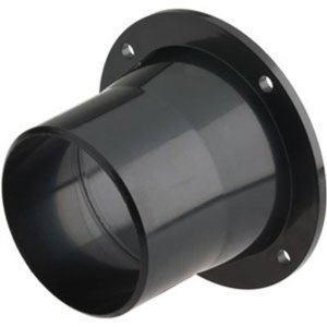

Cut a hole in the middle of the top that is vac house diameter. Fix a vac hose socket over the hole.
The vac hose socket is fixed at the hole using screws going thru the cardboard and into pieces of 1/4"x1/4" Pine glued to the underside of the top piece.
I covered the outside with a lot of duct tape. Easier to clean The 4 vertical sticks make good legs going down to the pillow blocks.
The hose weight will shift the dust funnel box if not planned against. I use bungee cords on the hose that are attached to a sky hook (my peg board tool holder).
A cyclone trap between the sander and the vac saves having to clean the vac filter every 10 minutes. The sawdust is fine and of a huge volume.
