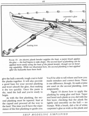

I was in touch with a Russian fellow on this forum awhile back about this subject. He seems to have disappeared however. Does anyone know of the technique where glue is applied to planks and then a small mini iron goes from one end to the other, effectively heating up the glue? I was told that this is a common practice in Russia but I’ve never seen or read anything about it. This is apparently used on the thinner second layer of planking.

I believe a very small travel laundry iron will also do. Note that this technique did not work well for me. I form plank beforhand to shape. Then I just ally it with PVA glue.

Not that I don’t recommend it. It just isn’t for me. It happened that when I applied planks with iron I too often had to pull them off later as I didn’t like the results. Maybe it will work for you just great

I do that techinque on my builds, discovered by mistake then actually thought I found something new.. LOL
I find it works very well with planking on the small scale I am working on now, my Nina in 1/150th. I use
an iron I bought at a craft store years ago, very small and available on Amazon. It does hold very well and is
pretty easy once you get the hang of it.

This technique is commonly used to apply veneer edge banding on plywood panels by cabinetmakers and carpenters. I use Titebond glue and a regular household iron.
I use this to bend pieces of wet wood around hull shapes. As the water turns to steam, the bend sets in. I also use it when applying a second layer of planking, as it dries the glue very quickly. I got my tool from Model Shipways - basically a soldering iron with a big metal head and a couple of wooden forms for bending wood. Frank Mastini recommends it in his "Ship Modeling Simplified."

I am glad the technique works for you. This technique very popular among the Russian community of modelers. Most Russian kits manufacturers use 0.6mm planks for the second layer, and the 'ironing' method works great!
