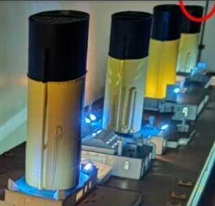

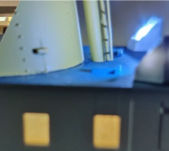

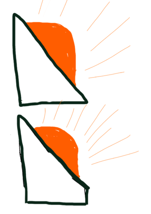

Looking at the images on magic scale models website of there lighting kit I notice that the lights for the funnels are in what looks like a triangle box tipped on its side and this has gave me an idea. It will be a bit of a fiddly job but in order to cut costs and use what lights are in the box then I'd say make these box's from a thin card and paint them white. They would be a bit bigger of course than the ones on this websites kit due to the bulb in the kit being bigger but building this box around it would help illuminate the funnels but will stop the lights being on full show from the other side because of the back of the box. The only thing with this kit on the website that I'm 50 50 on is even though it looks a nice lighting kit, it's to modern day coloured as the colour of lights back in the Edwardian period would of been of yellowish or orangeish tone, so the lights that come with the kit seem more to that style of colour but that's my personal opinion of course. Only thing I'm considering is the green and red light for the port and starboard box's by the bridge as I'm sure the light on the side of them boxs should be the only thing lit up and jot the entire box itself but correct me if I'm wrong. Ive done on my phone (as I'm currently traveling on train) a very not so good diagram of my box idea to house the bulbs that come with the kit around the funnel bases if anyone interested and included the screenshots from the website to show where my idea is from.
View attachment 250050View attachment 250051
Not a bad idea. As you said, would be fiddly work but if you can re-purpose items in the LED kit you get with the model, why not. ;-)
