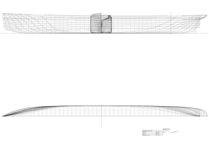

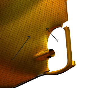

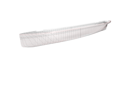

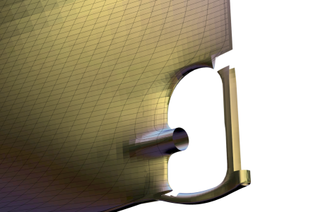

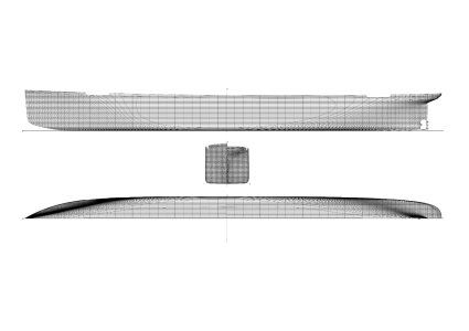

I used the plans from here, the front view is rather lacking so I was only able to achieve the best accuracy on the stern. It got me this far. Above the waterline, the bow curves are actually all straight lines between decks, since the curves in Oskari's drawings don't match up with any given frame (datum) station and are therefore mostly useless. If anyone has any other ideas where to find better datum cross-sections of the bow, since http://www.titanic-cad-plans.com is shut down for sales (permanently, according to the website), I'd appreciate it.
