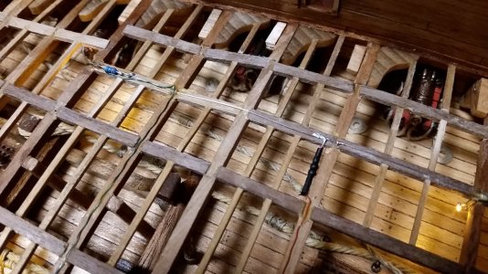

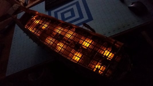

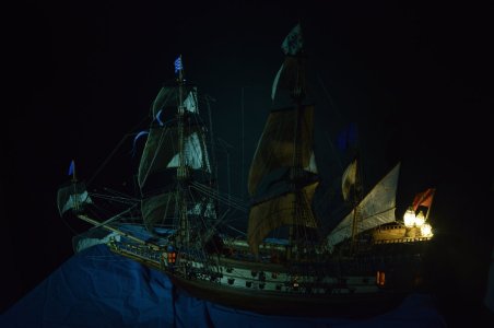

The wiring for lighting needs to be planned when you are assembling the framed and keel. The nano-LED's from Evan's Designs have wires as fine as a hair, and soldering them together at junctions is not difficult. If the lights are not too bright, they add a great deal of realism. The stern lanterns below are too bright, but the deck lights are just right.
Lighting with nano-LED's
Wiring and resistors hidden by sandwhiching them between beams and carlings and the deck overlaid atop them. The soldering doesn't have to be pretty. It just has to work.
