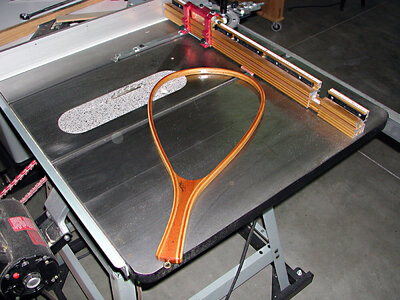

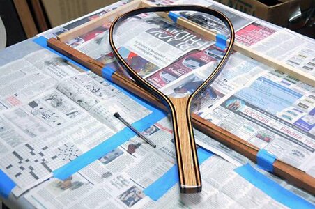

While I have not used Danish oil on a model (as yet), I have a lot of experience using it. Watco makes great Danish oil and provides a somewhat durable finish. A nice thing about it is after allowing it to fully cure (72 hours min. ) other clearcoat finishes can be applied. I make wooden fishing nets and after applying Watco, I follow up with Spar Urethane. It contains UV inhibitors and is waterproof. And it looks good!
As a reminder, if you use rags to apply Danish oil, soak them in water then spread and allow them to dry OUTSIDE. Do not leave the oily rags in your shop. They can combust!
