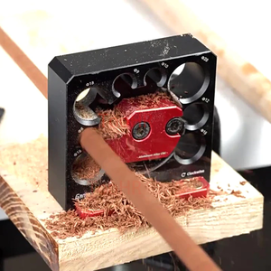

These things are also great for making round blanks.
I have to agree with you, Sanya. However many of us don't have such tools at our disposal. I have seen many self-made tools on youtube. I think at this price it is not a bad deal...

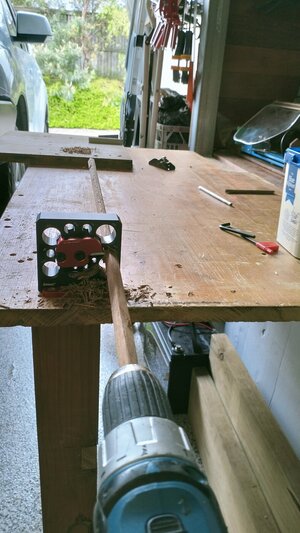

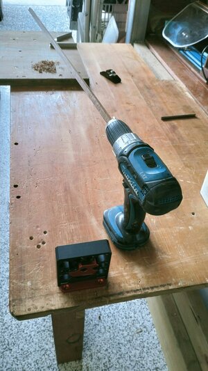

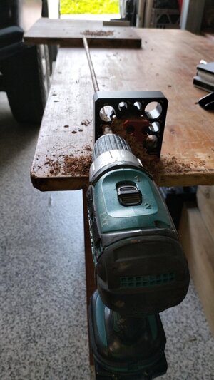

I have this tool (from Aliexpress) and I highly recommend it. I started with square timber but planed off a small section to rough round for the chuck. Powered by my Makita cordless drill, I ran it through 12mm first, then 10 and finally 8mm to make a very acceptable Mizzen mast for HMS Medea. I haven't sanded it yet (I'm avoiding dust until fully recovered from surgery ;) ).
I found the tool worked best at the highest speed on my two speed drill. Photos to come.
A couple of images. Cost was less than AU$20 delivered so I consider it good value.
