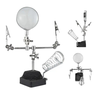

Jgsandberg, that's a great Idea. It got me to thinking an alternative is a pair of "helping hands" probably less costly.
Yes I agree with what you're saying, it may work. The advantage of using tying vise's are that they clamp down solid on the eyebolt, as they are designed to do, and you can apply substantial tension on your work,as evidenced by the thread bobbin hanging from the middle with minimum deflection. That allows you to apply very tight wraps, similar to a serving hammer IMHO View attachment 4093633675B44E-844E-4713-9739-7249FACEF123_1_102_o.jpeg
