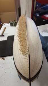

Also Brian you can use wooden tooth picks ,much better than balsa also you can soak them in any stain depend what color you want for the treenails.
I like the tooth pick tree nailing the most. I use beech for these instead of bamboo as these are easier to cut after fitting and dont spline. With tooth picks you can even first colour the outside black before fitting to get a real look.
I dont know why a lot of people use brass instead, this as brass wasn't used in the original as well and it is much more difficult to sand down either.

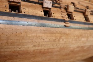

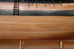

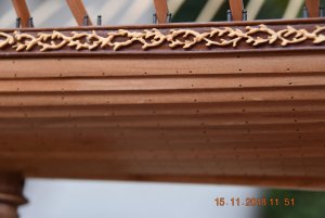

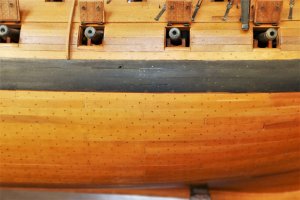

See below the result on my RC with beech tooth picks ( cocktail pins as we call them)

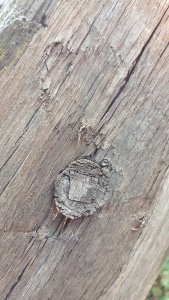

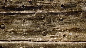

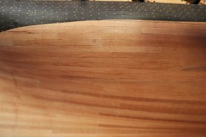

And real treenails in my anchor.
And vasa

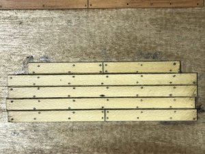

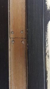

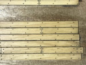

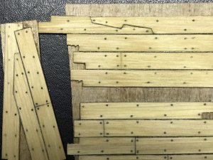

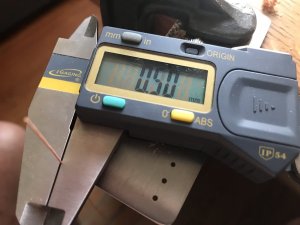

On the Hornbeam there mix (some wood treenails some wood filler) Holy and Pearwood actual wooden treenails, They are 0.49 ~ 0.5mmø. I like to match the treenails with the same type of wood as a deck.

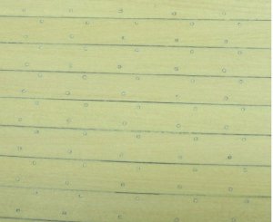

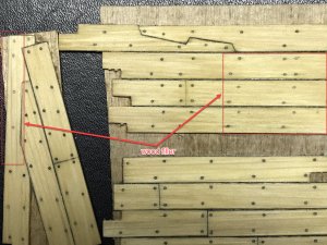

- drill the holes for all of the treenails following the pattern shown on the plans.
- sand the area smooth
- use a sharp awl and gently insert into each. Don't push it too hard or you will distort the hole shape.
- take a very sharp #2 pencil. Insert point into each hole and twist lightly. You must keep a sharp point and sharpen the pencil every ten or so holes.
- then fill each hole with Elmer's wood filler. Scrape off excess with a piece of wood.
- Sand it smooth to get a nice surface. (see below)
Hope this will help

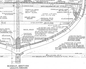

1) a lot of these connections were done with copper or iron bolts, sometimes these were up to 2m long
Take a look at the USS Constitution
https://ussconstitutionmuseum.org/2016/02/17/bolt/

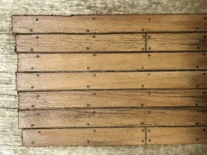

Here some photos from Rochefort of french built models showing this
The french likes very much the brass nails, also sometimes on decks
