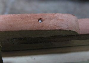

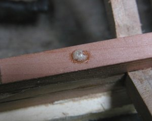

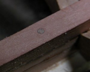

I have found after a certain size wooden pegs no longer are effective they are so small the joint will just snap apart including the peg. so I tried plastic pegs but even those will just break and one big draw back is a limited color choises. The best stuff is beading wire that comes in all different sizes.
another idea I tried is first drilling a hole
then I used an expanding glue like Gorilla glue and just a little squirt into the hole
the glue will expand and fill the hole
a quick and simple pass with fine sandpaper and there it is.

Dave, you're a genius! That works for larger rivet heads, but I'm dealing with micro sized ones.
