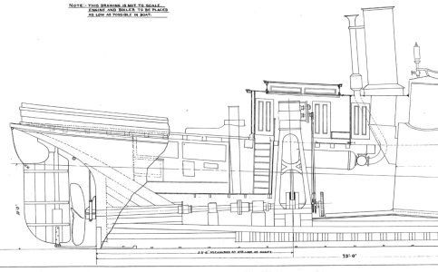

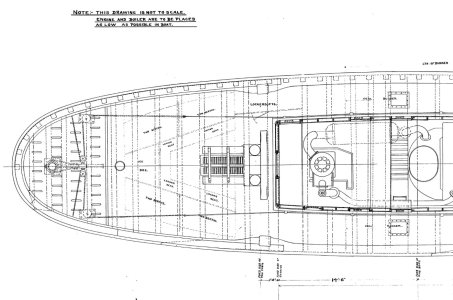

The two lines drawings: I suspect that these tugs were side launched. I have an early 1900’s book by a Great Lakes marine surveyor named Curr comparing innovative shipbuilding practices employed on the Great Lakes with those on the River Clyde in Scotland. He makes the case that by side launching, construction of the vessel could be simplified by building it with the keel level. With the keel level, it would be easier to erect the frames perpendicular to it. This would of course require that the hull be lofted this way.
A lines drawing with the stations drawn perpendicular to the waterline shows the vessel’s underwater shape as she actually floats. Perhaps it was made for this purpose. Unlike most vessels, tugs require immense power with the vessel moving very slowly or even standing still. Flow to the propeller at the after end of the boat is all important. A lines drawing drawn this way might have made this characteristic easier to visualize.

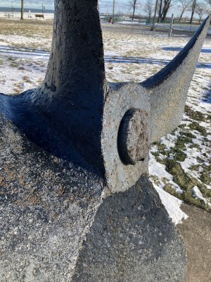

Thanks for the pictures seems like such a while ago, It was a fun build, I thank Dave Stevens again for all his help and plans,, It now sits in our Orthodonists office in Rocky River, Ohio, Bill S.

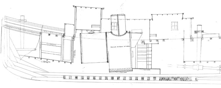

i would have loved to 3d model the engine of the Alva B but there just are not any detailed drawings that i can find for these steam engines. Nor could i find anyone who actually dove on the wreck to see if the engine and boiler are still there or if they were salvaged.

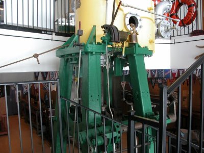

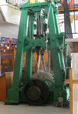

there is this steam engine that was or maybe still is in the old Great Lakes Historical society museum but i have no idea the date or where this engine came from. Or if it the type used in the Alva B
