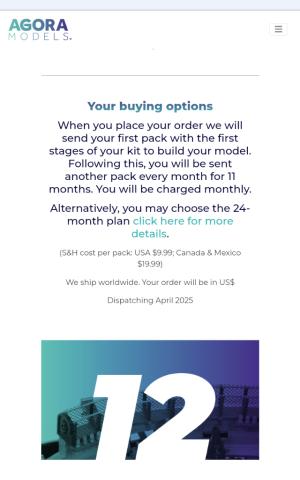

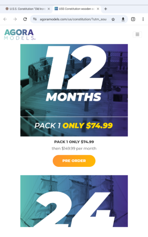

By the way, the way it works, is that you don’t buy the kit outright, but rather its split over 12-24 months. Some people love this concept others hate…. It has pros and cons, for sure.
they have 2 payment plans...
the model is $149.99/month for 12 months, first mo is $74.99
24 months is $74.99/mo, first mo is $74.99

The price for any given model... whether you pay monthly over two years, or in one big bang... is always in the $2000 or more range. In this case, $1915 USD, plus monthly shipping fees. And not all kits they sell are available as a single complete purchase. They start off with the first mailing of (typically) 24, and in a lot of cases, they've only had the first few months of a particular kit produced. But their site will always show if a kit can be purchased all at once and shipped all at once. There are a lot of companies playing this game now as it's a real money milking machine for them. In our case, it seems this is the option we have that can be purchased in Canada... but shipped from the US that means we also need to add another twenty to twenty five dollars per shipment to cover the brokerage handling fees the courier company will charge us to bring it across the border. Now the outfit that sells these same subscription kits in the Europe (I watch YouTube videos of a guy in the UK who builds them)... also provide a magazine with each shipment that includes the build instructions, along with a lot of historical and background information associated with the model being built. We don't get those in North America. But Agora Models is legit as far as that is concerned, but simply expensive.

Correction.... if you go the 24 month route, it's $74.99 USD for the first month (as you've noted), but the remaining months are $79.99 USD each.

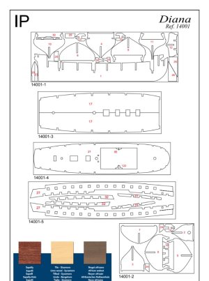

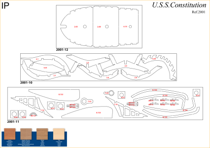

More coincidences. This extract of the "pack 2" found here shows the same style template of the identification sheets and the wood samples in the bottom left corner, just like any Occre kit...
On the left, the U.S.S Constitution identification sheet, on the right, Diana's. Same style

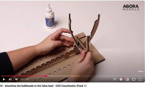

And the clearest one (!!!)
This is a screenshot of one of the building videos found on their website, as they are still hidden on YouTube.
They are clearly and (I think) knowingly ROTF using Occre's Cola Blanca (wood glue) and their recognisable bottle.
