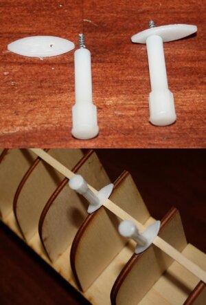

With regards to the first planking, I punch the nails into the wood. Second planking goes smoothly over the top, but I use planking screws for the second planks.

they can be used for most scales. I like the fact that they screw into the first planking tightly. Push pins can come loose easily.

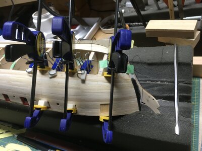

I use CA gel to apply hull planking. Spot apply the gel, set the plank, and hold for ten seconds. Regular CA thin whacks into the wood too fast to provide a tack. The gel CA stays thick until it sets. I occasionally need to clamp hard bends but if patient, you can still hold in place until the CA sets. For me, CA gel works for planking.
