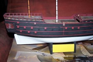

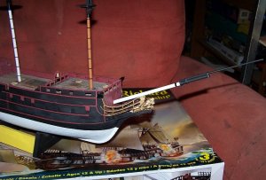

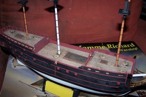

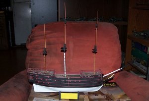

Now back to the build. I have attached the figurehead and decks and based on a model I found in google images I have painted the hull and masts.
build progress 001.jpgbuild progress 002.jpgbuild progress 003.jpgbuild progress 004.jpg

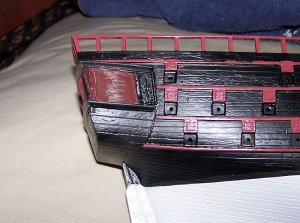

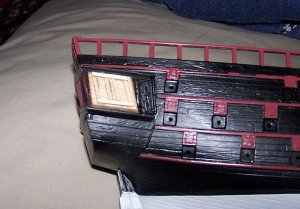

Here's my first attempt at building new quarter galleries out of wood. The trick will be to duplicate the effort on the other side.
