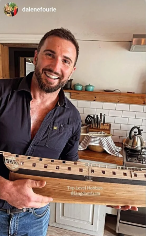

We were fortunate enough to win a great wine award and one of the countries top wine writers came out for an interview...what were they interested in hearing about? Constitution....this photo made it onto their social media platform. Maybe it inspires someone to join the club!
Congratulations on the award. I've enjoyed one or two wines from South Africa over the years, admittedly, it's been a while, but I recall one Chenin Blanc as having been among the best I've sampled. May I ask the name of your vineyard? and what wines do you produce? Might we find a representation of these anywhere in the US?

Sorry, didn't mean to clutter your build log with the detour, but, you did open the door...
Once again, congrats - not just on your award, but on your build! Great picture, causing me to double down on my conviction that you should keep the finish as natural as possible. I'd hate to see all that beautiful detail covered by black paint.. Since SoS started a new page, I am copying the photo from your post to here.

A strange post today but I thought the forum may enjoy this little titbit.
View attachment 638678C
Congrats on the wine award. Very cool photo. Cheers Grant
