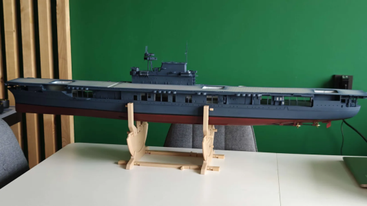

and a big moment for me was that I painted the hull, used Ammo ATOM ocean blue color. I must admit that the coverage these paint have surprises me every time... I can paint a lot more with them than with the same amount as Tamiya or Mr. Hobby. And I like the color

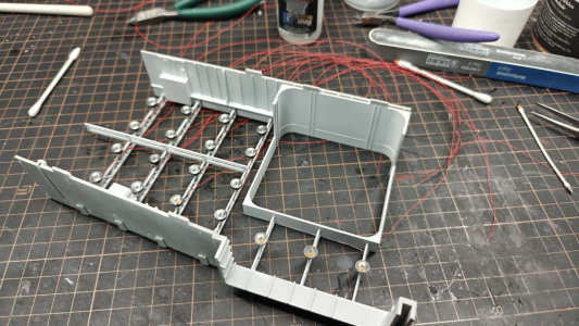

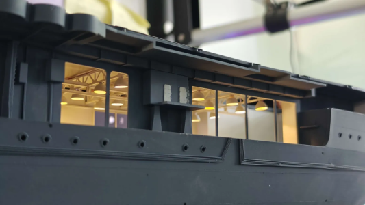

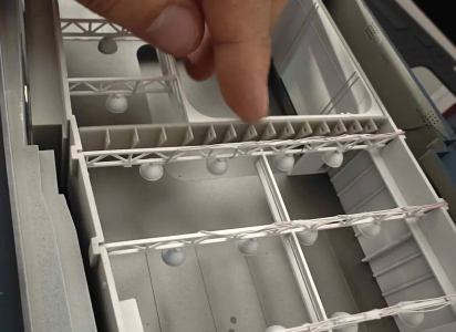

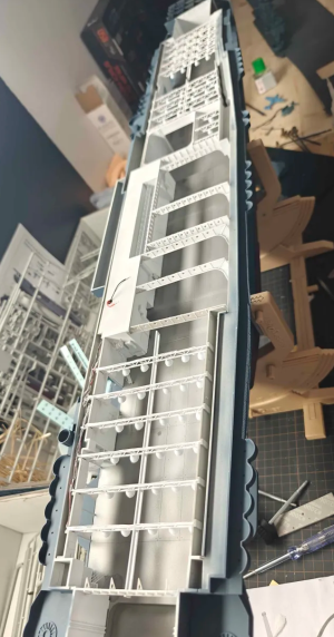

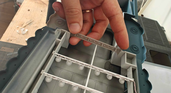

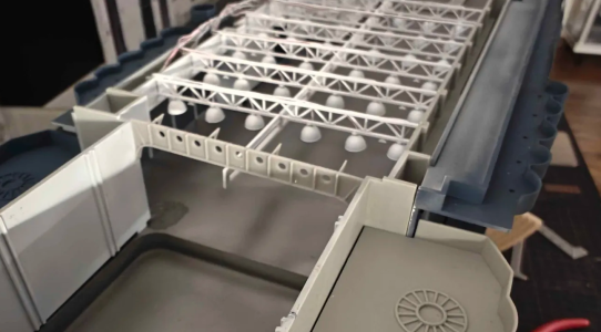

Since I started with the LED, I need to know how to route them, and for that I dry fited most of the parts to understand what would be the best approach and for the first time I saw the size and general shape of the ship... I like it... I like it a lot

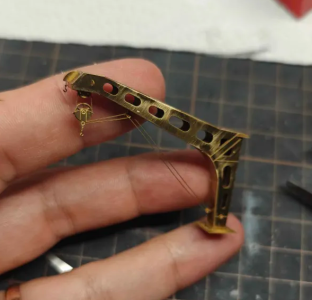

Anyway, I am moving forward slightly, a lot of PE... but what I wanted to show is that I am making the lights for the inside. I made the lamps from a picture I have, but the size is probably wrong, but in my opinion this is better than seeing the LED strip :) Just need to paint them.

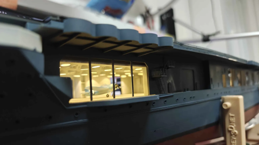

So it has been a while, but I decided that showing more progress is more fun :) so here goes...

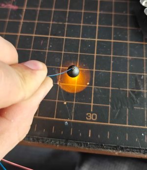

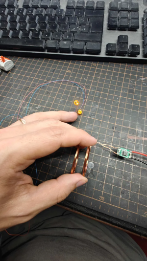

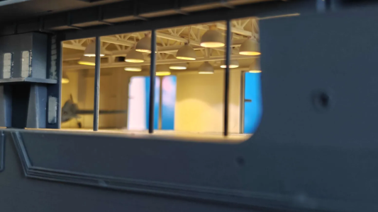

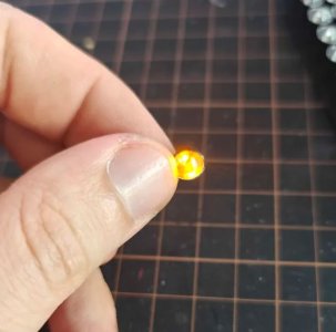

I really dislike the idea of drilling holes in models and also I really wanted to test out the induction method for power up the ship
Then I continued on with the metal for the ship, more to show than to tell :)
Other nic nacs are also being done
and ofcourse a ton of test fits

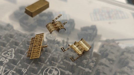

Also I got a addon for the planes, I will try to "hang" then as they were but for that I need to cut the plane wings. I know I can buy the KA models that have folded wing option but they are too darn expensive :)

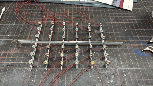

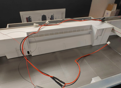

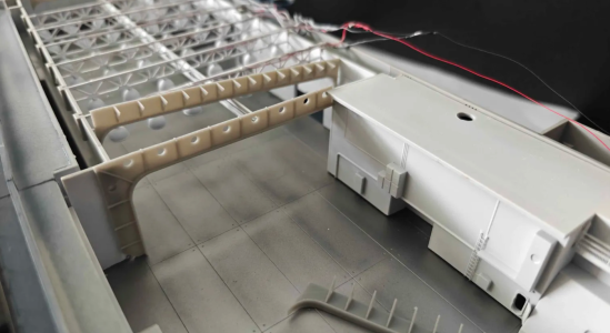

The snakes nest of wires are being done
another test fit

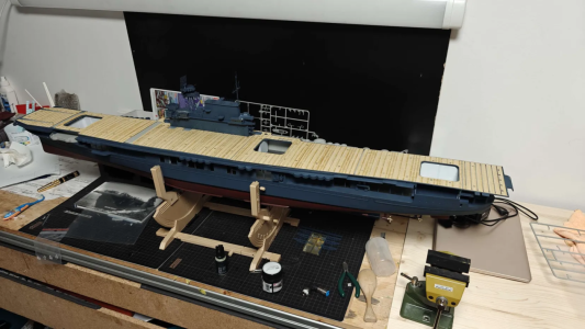

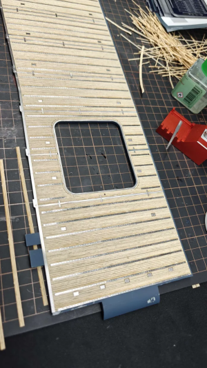

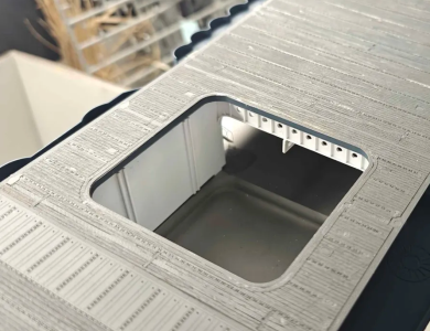

I started the deck, it was quite tricky at first, but the tricky part was to peel off the double sided tape and not destroy the deck in doing so.
Then came the metal parts for the deck, this took soo much time...

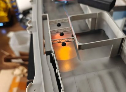

Some lights inside

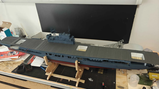

I painted the deck. I really liked the natural wood color, but well I can't have that can I :)
Another snakes nest (the final one from the kit) Everything is fine here, but I am missing a LOT in the plastic that is in the center, I will probably have to make some structure parts with my 3D printer to add light to the center...

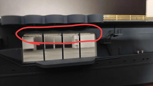

Anyone have any pictures of the center part of the ship ceiling for some references?

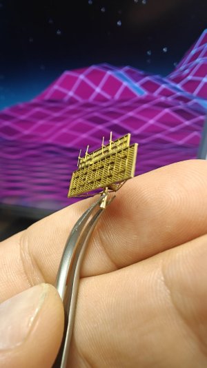

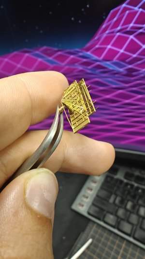

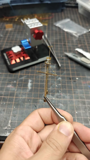

And I came back to do some antenas
That's all for now, more to come

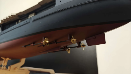

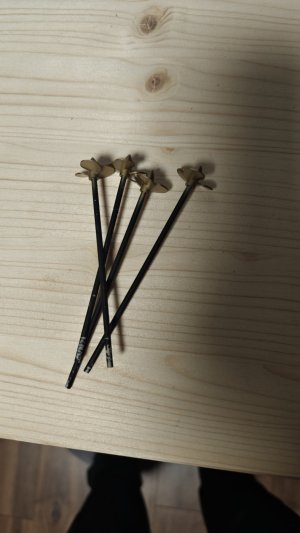

the ship's props should be counter-clockwise on portside & clockwise on starboard side.

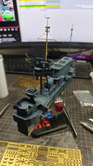

those are the wrong radars if doing the ship as of the Battle of Midway as they are late 1943 into 1944 time period not June 1942.
I found them on the book, I could get away with it without repainting it i think, but not adding the radars would be a shame because they look really nice, but not midway anymore... Not sure what to do
can you post all the radars you have or is it just those 2?
There are no more that are added. I just got ahead of myself and made all of them, the one that is on the side, the main one on the top and the two half oval ones in front and back of the main structure. The one I am missing is a small SC secondary air-search radar antenna that was installed on a four-legged pedestal on the top near the chimney and from photos i see it was added later in 1943 (that's what the books say)
read this carefully especially the dates concerning radar.

Really impressive did you get the inductive method to work? I saw the lights on so I am assuming it works. Perhaps you could go into more detail.
Thank you. Yes, everything works, the coil is from Aliexpress, it was about 10eur. Now the transmitter coil needs 12v for bigger distance, the lower the voltage the lower the distance it can work. The distance is not that big to get the full power for my 3v LED, about 2cm would be MAX I would say. The positioning is quite critical. Not it gets warm, can't say how warm because I didn't try it for long periods. The idea in it self works. Now if I would put the ship on posts this would probably be bad for the distance, for a flat base its good. Otherwise there is not much to tell... I bough 5A one because I am wiring a LOT of LED so yeah... its good that I have space in the ship... Thinking of installing a battery inside, but probably for safety I will install one on the stand so I could see if its going bad... Also I would love to make a epoxy base for it but for that I am really worried because it would weight a TON and I am putting the ship on glass shelves. But I want the resin to be clear'ish not the painted on so the wireless electricity came from that (in order not to see any wires in clear epoxy...

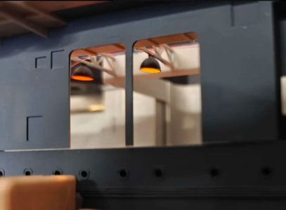

Some lights inside

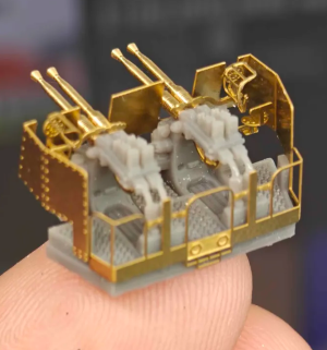

Big thanks to Davidp for additional infomation on the arment. So I post quite rarely, but the build is moving forward, so here are the updates for now:

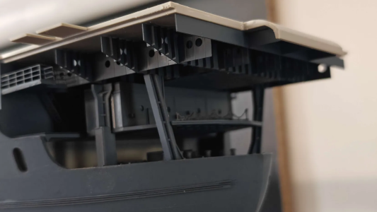

I went digging on some photos for the structure in the middle. I am not trying to be super accurate (that's actually impossible on the ships design but I really wanted something more for the middle of the ship so I started making some beams from photos that I found

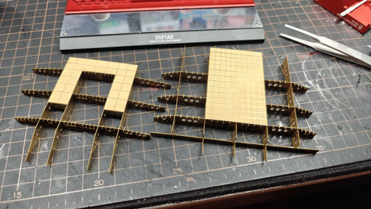

also I started doing some stuff for the lifts, Trumpeter offers no details for them what so ever, no beams, no bottom structure... So Little by little I will do something with them.
the center section where the props are held is really different from what I have, so that made me sad a bit, but it is what it is, I will make some adjustments for it later, but any modification takes a hell lot of time that I don't really have...

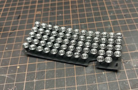

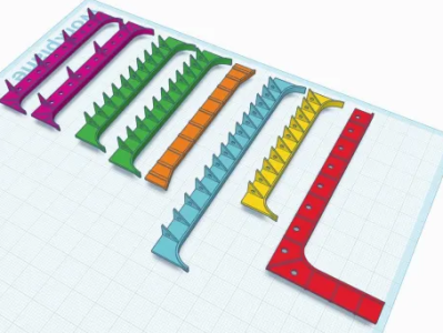

First test prints for the beams look like this:

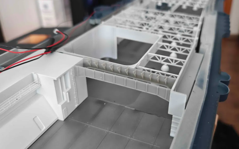

covering the holes...
I am getting closer
and I also done some metal work...

Dear savas! On ships with 4 propellers there is the following rule: the propellers of one side rotate only in one direction. In your case, the propellers of one side rotate in different directions, which would lead to destructive loads.
In addition, the propellers on different sides must rotate only in opposite directions.
Rule: Both starboard propellers should rotate to the right when the ship is moving forward, and both port propellers should rotate to the left.
