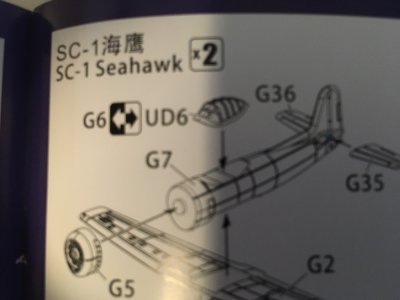

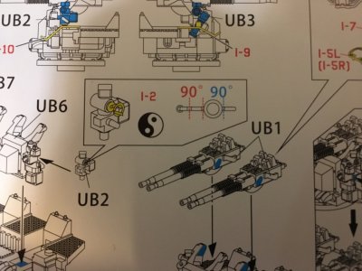

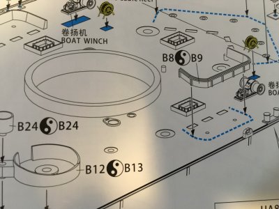

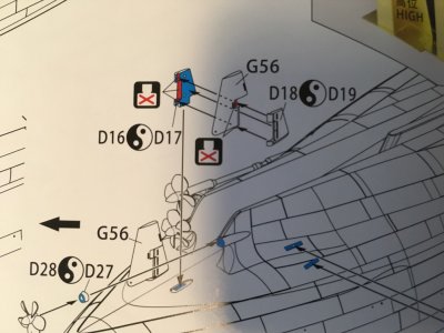

The Manual
To assemble the model, you will need to follow the sequence of steps designed by the manufacturer. The Joy Yard Missouri kit is no exception. Provided as a booklet, color printed on a total of 12 pages, it will guide your assembly hours to a successful build. In my opinion, it is very intuitive, the images are crystal clear with notations in English and Chinese. all instructions provided symbols of how parts should be handled. What I like most about this manual, is the accompanying photos of the pilot model to help further identify the parts placement. Take a look at the sample images.
View attachment 331517View attachment 331516
