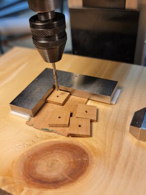

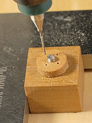

Below is my PROXXON press drill used for thickness sanding. But the MF70 worked MUCH better as you accurately can manage the thickness. I will look for my pictures
I used my MF70 for bigger pieces of wood when I was building small deck pieces.
As you can see, the MF70 can cover many jobs. It is design for milling. But I use it also for precise drilling (drill press) and also as a thickness sander for small pieces of wood, if needed.
I found the investment on my MF70 tool a good one.
