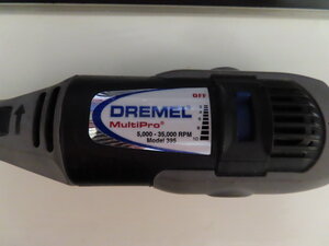

this is a picture of my Dremel. I think overall, it is just too powerful for Ship Modeling. I probably need a cordless unit.
What I am looking for is to slow the Dremel WAY down to let's say about 300 - 500 RPM
