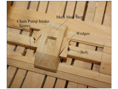

The masts do NOT move at all.
This is partially true. Foremasts and mizzen masts were fixed in place on English Ships of War, but not the main mast. The shift to bolting and other methods for securing the main mast started with the transition to iron masts and steam-powered warships. At least in the 18th and first half of the 19th century, the main mast on English ships of war was wedged in place so it could be adjusted fore and aft on the keel to change the rake. The mast was square on the end to fit the mortice in the step so could not twist, but fore and aft adjustments were made via the wedges. I have no idea if this was done on merchant ships or on any ships of other nations.
Wording in typical English ships of war contract.
The main Step to be sided 1 ft 11 ins and 15 ins deep on the Keelson and of a length to slide easy by the Stantions of the Well.
Interesting. There was clearly a reason for such a mechanism and presumably the movement of the mast foot would be amplified at the mast head. But what effect would altering the rake make? The wind pressure on the sails is ultimately transmitted to a driving force on the hull via ropes: shrouds, braces stays and sheets.
