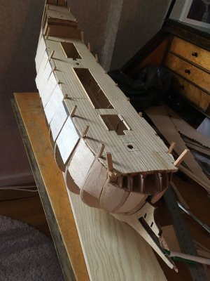

Carrying on with some deck underneath the gratings.
I made some deck pieces for the upper cannon deck as I thought you could lift the gratings.
But now that I see how much you see of the upper deck, I have started thinking about making a larger part of the upper deck. In that case, I should make the hull first and then remove the fake deck and with a Dremel take out the frame completely about 35 mm down so that the upper gun deck can fit.
After all, I can always make the hull first and then decide how to proceed.
Have started to fill in with balsa between the frames. Shouldn't need to fill in where it's completely straight, but unfortunately my experience is that I manage to get the planks uneven even there if I don't fill in. I'm just plain clumsy.

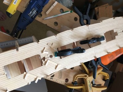

Planking takes time, but at least now I've come a little along the way. Thinking about what I would do with the bottom plank here?
I'm going to plank twice so it's not something that will be seen, but it would be good to try to understand how to get it better the second time.
