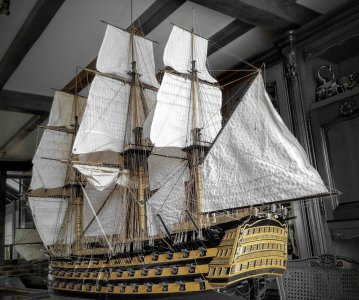

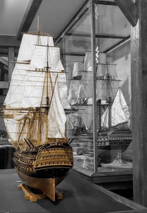

Bonjour, j'ai réalisé un modèle du Hms Victory à l'échelle 1/64e avec les voiles et le gréement. C'est un choix que j'ai fait avant la construction (sur plans du musée national de Greenwich et des livres de John McKay, Alan McGowan, Nepean Longridge et autres documents). Il est vrai que selon les angles de visions sur le modèle, le gréement est en partie caché par les voiles. C'est le choix que j'avais fait à l'époque et peut-être pas le meilleur.
Francis
Hello, I made a model of Hms Victory in 1/64 scale with sails and rigging. This is a choice I made before construction (based on plans from the National Museum of Greenwich and books by John McKay, Alan McGowan, Nepean Longridge and other documents). It is true that depending on the viewing angles on the model, the rigging is partly hidden by the sails. This is the choice I made at the time and perhaps not the best.
Very good work - maybe once you are able to show more details f.e. in a topic here:
Francis
Superb model, particularly the sails. Would you explain your photography method please? Black and white background, colour Victory.
Francis
I love the fact that you have sails, that is my preference. A sailing ship looks naked without them. Without sails, the running rigging loses it's purpose, and the storage locations of such rigging hide the purpose of those lines.

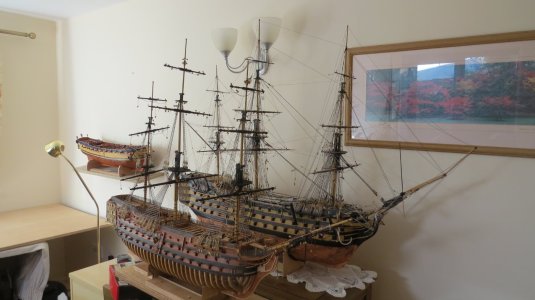

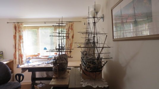

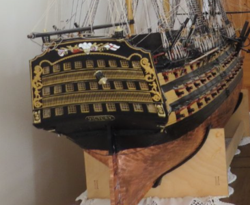

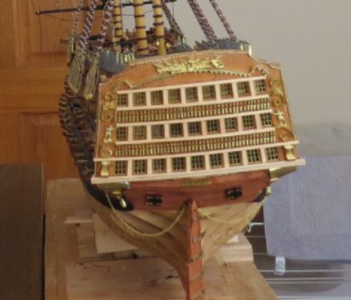

When I started the Occre Victory I thought it might be interesting to compare it to the Caldercraft Victory I made a decade ago. This might help people to decide which of the two models they should go for – it would seem that they are both represent the top of the Victory model range each with a cost in excess of £1k.
Anyway as I am now on the rigging stage of the Occre its about time to give my humble opinion of the plus and minus of each version
So here goes……………….
As you see below I have scored each model using a variety of categories, giving each a score or 1-5 (1 being low and 5 high). As you can see the Occre Victory comes out top with a score of 60 with the Caldercraft having a score of 53. In other words according to my scoring criteria they are both score almost the same. As any project manager would tell you (I am one from the IT world!) scoring is all very well but what counts is what one actually thinks
A big plus with the Occre are the Sails, Oak Hull and the small size. A big big negative is the lack of instructions and terminology just missing. Once you start making the model one forgets all about the posh box it came in (it comes in a custom made wooden box complete with limited edition medals etc). Having just started the rigging my knowledge of the terminology of the Victory is no further forward than when I started – they don’t even mention the various decks, catharpins and futtocks!. I build model to lean about the ship – its not just a collection of wood and metal which is the impression Occre seems to have.
The Caldercraft copperplated hull is a big plus – its really does look good. Also the instructions are simply superb. When I built it I was not an expert builder of models – the most complex model I had made was very simple model ships and planes in my youth. However the instructions enabled me to build it without too much trouble; when I got stuck - which was’nt very often a quick look at this forum put me right.
A comment on the Occre Victory by Neilm is worth noting – he says “Occre just abandons any detail after the main build. Poor customer care, loads of money on the kit and such poor instructions. Shame on them . Avoid this kit if you haven’t the skills to rig.”
He is right on all counts; however I have got to make my mind up. Which model is better..
I have to say for a modeller without too much experience the Caldercraft is the better one to make. This is due to the superb, easy to follow instructions and also the fact that you learn all the nautical terminology.
For the more experienced modeller I have to say its rather a toss up between the two. To simplify matters – if you want sails chose Occre, for a copper bottom choose Caldercraft
What do you all think??,. Let the debate start
I do like making a Victory – am very tempted to make a cross section – but that’s next years project as I guess the rigging on the Occre will take me into Feb/March next year.
Have put photos of the two models side by side so you can make your own mind up

Main Cabin
O – Windows better and metalwork easier to fit (no individual items)
C – Metal work all pre formed so looks more accurate
4
3

Thanks for posting this comparison! It is very useful for choosing between the two kits. Many members debate the details of the scoring, but what's important is knowing the contents of the kit, and how the model looks when completed. The shape and proportions of the components is very important as Uwe pointed out if one is looking for accuracy in a model. Details like the windows, lack of sails, and other accessories can be replaced or scratch built, but for most modelers, accuracy comes first.
