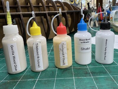

Donnie. I have a bottle of weld bond that a bought quite a while ago. I seldom use it as it is so darn thick I have to use a brush to apply it. I've tried it in my plastic squeeze bottles and syringes and still can't get the glue to come out as it's so thick. You can get it to come out of those syringes? Do you thin it? thanks.
Okay... I mixed a little water to thin the Weld Bond. I glued a few small pieces of 1x4mm strips together last night. Works just like the thicker Weld Bond. Wood breaks before the joint comes apart. Thanks Donnie. Added Weld Bond back to my collection of wood glues. Can't have too many you know. ROTF

Where'd you find those bottles with the colored caps? They look pretty hand!
Amazon (LINK)
If you forget to put the cap back on the glue will harden at the tip. I use one of these to unblock it.
LINK
Signed in to Amazon to purchase the 24 x set then deleted the item as the shipping cost to NZ was twice the price of the bottle set. Gotta love international postage cost. ROTF
